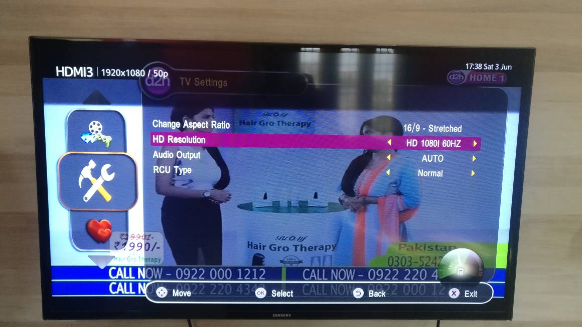

Hello Video Experts,
I was using a TV bought from USA with VideoCon D2h STB. I was able to change the mode to 1080P60 earlier and get it working with my US TV.
Recently, for some reason we had to do a factory reset on my Settop Box and now not able to figure out how to change the HDMI mode.
Appreciate if help here. Basically, looking for instructions to change the HDMI output to 1080P60 on Videocon D2H.
Setup > Installation (Default code 1234) > TV Settings > HD Resolution.
That helped me too. My sound was set to stereo. Changed it to auto. Now my avr recognises the input signal as 5.1
