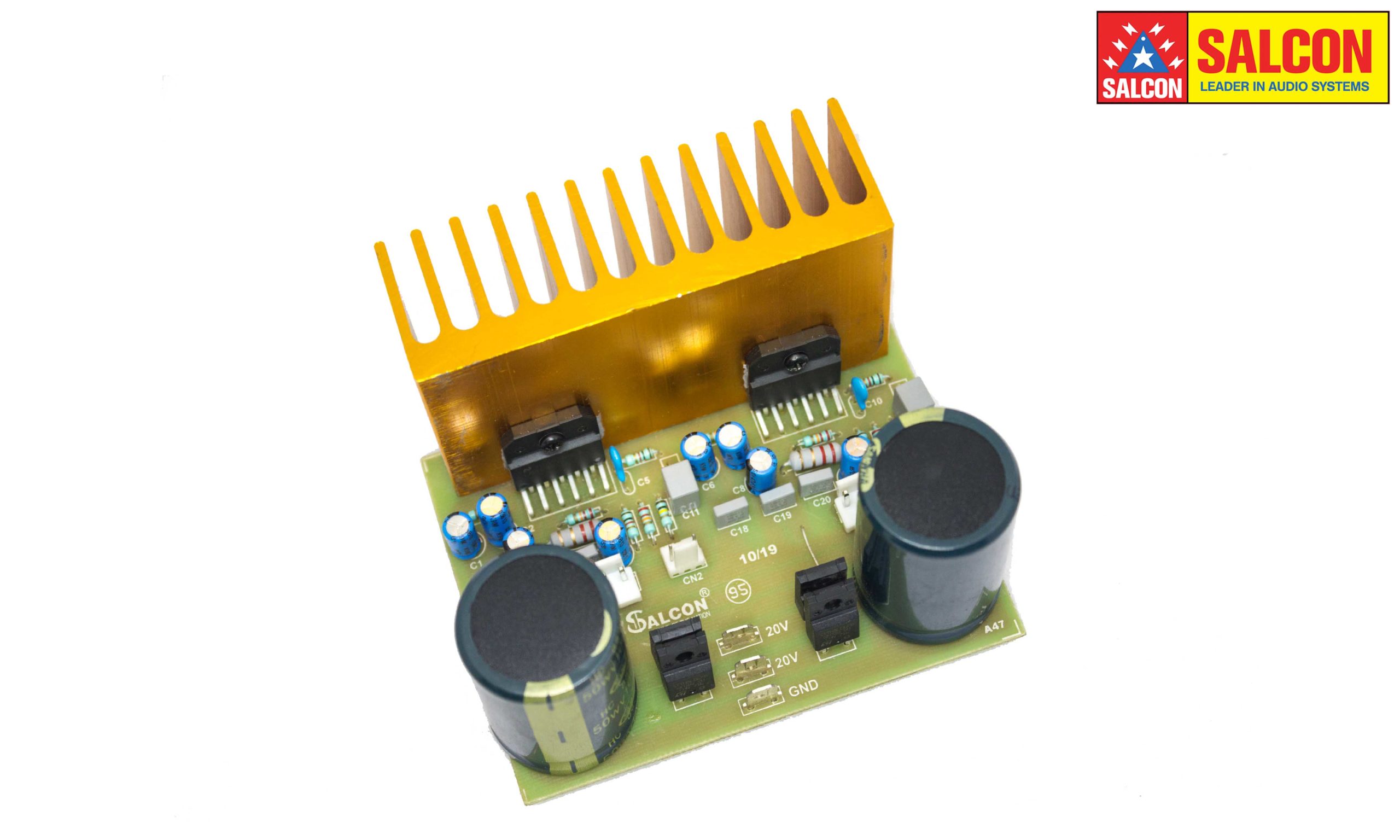

@Hiten I'm thinking more about a tpa3255 based one. Getting a genuine lm3886 nowadays is a concern. A Delhi based company called salson also advertises a lm3886 based board on their site. Don't know whether the chip is genuine
