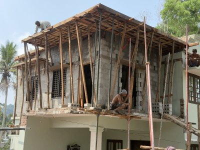

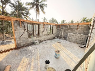

At this stage, unfortunately, it’s not practically possible to create non-parallel walls since the room is coming up in the front balcony area and the structure is already defined.
