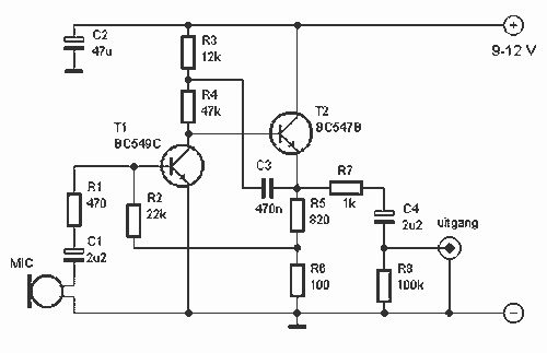

maybe you can try something like this, its simlar to the microphone preamps on Ahuja amps:

i have bought some mic preamp circuit from local chadni shop which is a replica of the first circuit you have attached.

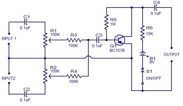

well, in that case, what you actually need is not a mic preamp but a audio mixer like this one:
You can connect your mic preamp's output to one of the inputs and your cd player to the other. You can then adjust the levels (R1 and R2) to have your mic's sound superimpose over the cd player's sound.

The output of the NE5532 preamp should be mixed with your music source (DVD), hence you'd also have to build the single transistor mixer circuit to mix your NE5532 preamp's output and your DVD player's output. If you want to avoid the single transistor stage, you can use a passive mixer with 2 pots at this point as well (but not sure if you will have full control over the gain without a transistor stage).
