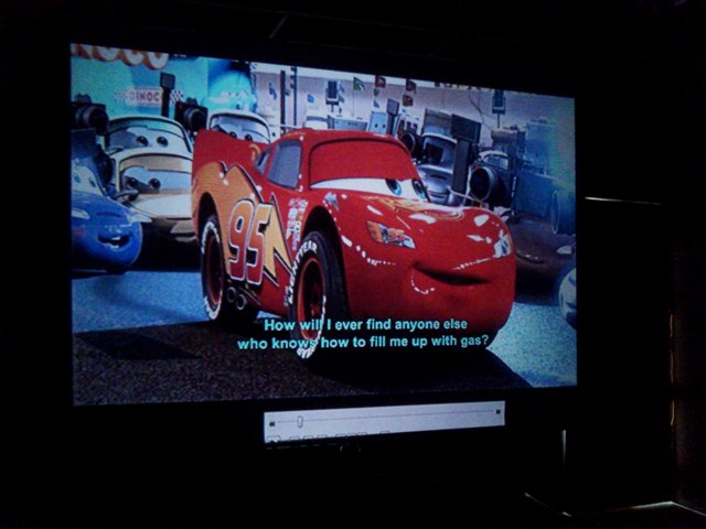

For reference : A screenshot from the HD movie "Cars" in my diy pj using my mobile camera
(I will try to post the same screen shot from my current projector, if the movie is still there in my archive)
Using player other than vlc say MPCHC will give more detailed PQ.
I had tried MPCHC and couldnt find a difference in the DIY Pj but I could find difference in my current PJ (Optoma HD20) and hence I am using it now (HD audio bitstreaming using ffdshow is another reason). Need to combine it with XBMC.
While doing the diy pj, I had compared it with some projectors in my office (Sharp / Viewsonic / Epson) which are entry level. What I observed was that the PQ was better in them (not huge), but when we go up the ladder the difference was becoming day n night even for HD content. (I am talking only about the PQ, not based on the other factors like screen door / even lighting which are related to the projector design).
The PQ which I am getting in the above picture is somewhat the best possible at a 110" 16:9 size from a diy pj (its slightly more sharper in person). Any claims for PQ similar to commercial projectors are nothing short of utter lie. To me DIY is more of fun and learning and it doesnt make any sense to spend similar to the branded ones for diy as I dont have time n money to waste and no intention of becoming a human god with followers as we have seen a hell lot of them.
