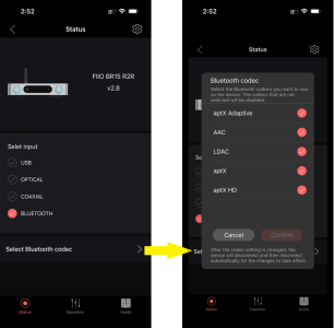

BR15 R2R - Bluetooth Performance - Flawless
I am using BR15 with Bluetooth for hours every day and it has worked flawlessly.
Paired with nVidia Shield Pro and it connected with LDAC automatically, which is the best shield pro could do. I literally have no complaints and can only praise convenience of Bluetooth with such good performance.
No dialogue intelligibility or clarity issues with TV shows or movies. Music sounds as good as well.
I don’t have any device that could do lossless Bluetooth at the moment, but it should perform even better with that.

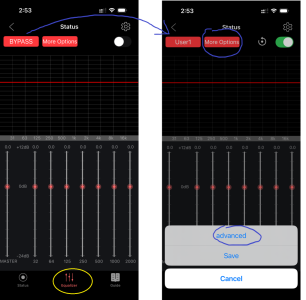

* How do you access PEQ feature - FiiO Control Mobile App vs Web App on Laptop/PC
Option 1> FiiO Control Mobile App
Available on Google Play Store & Apple App Store.
App discovers the device if it’s powered ON and Bluetooth is connected.
*Note - Enable EQ (any profile) on BR15 R2R first to use PEW features on App

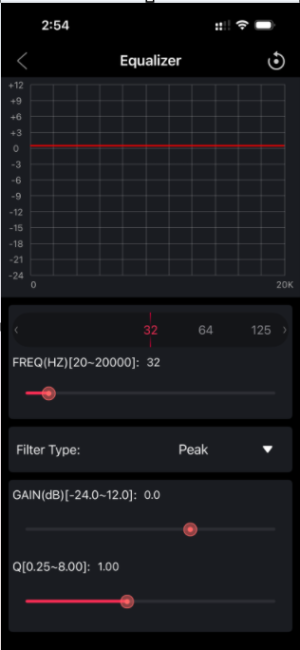

You can use sliders to customize the EQ
***To use Detailed PEQ settings, go to "More Options-> advanced"
