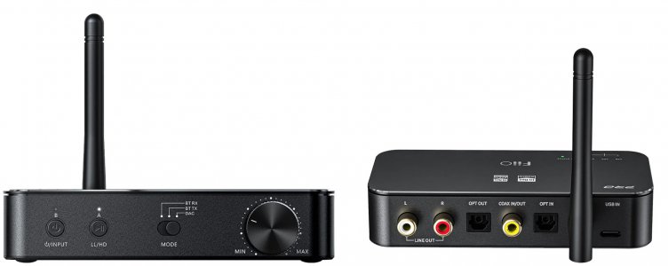

The FiiO is a palm size & a unique devise, and I selected it for the following features:
1. Unlike the rest, it is a combination of DAC, Bluetooth receiver, Bluetooth transmitter and a pure digital transport.
2. Inputs: USB, Toslink, Coax and Bluetooth; Outputs: Digital: Toslink, coax and Bluetooth; Analogue Outputs: RCA pair. All highest Bluetooth codec including LDAC are supported with long range receiver and transmitter.
3. In-built zero gain ADC volume control.
4. Hi resolution playback support on USB and up to 192khz on coaxial and optical.
5. Digital conversion from input to output, meaning whatever is input on USB, Optical or Toslink is simultaneously output as Optical, Coaxial or Bluetooth (in transmitter mode).
6. Similarly, whatever Bluetooth signal is received in receiver mode, is output simultaneously as Toslink, Coax or Analogue signals.
7. It has a fully featured Android and IOS app which gives full control of the device.
8. ESS Sabre DAC, Qualcomm Bluetooth chip and Comtrue CT5302 Audio Bridge, OPA1662 OP amps.
At around Rs. 10,000, it is truly versatile offering all common digital inputs and outputs, hi-resolution playback, a well-implemented volume pot and top of the tier Bluetooth codec support in both receiver and transmitter mode.

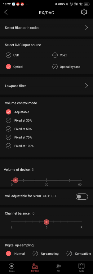

@Kannan nice review, in functionality you have mentioned "can use it as a pure DAC if you have an integrated amplifier or a preamp by defeating the volume pot". does it allow to bypass the volume control on Fiio device.
I am building a turntable centered setup, but also need a low cost option for digital files playback via laptop (foobar or something else). i have a tube pre amp with spare rca input terminals and want to feed them with bta30pro. Any suggestion.
yes, the volume control of the FiiO can be defeated.
Above is the screenshot. The setting has to be done using the FIIO Control app for phones
