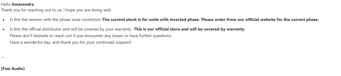

For those interested, the much awaited Fosi Audio V3 mono has been launched in India via Amazon. However the sales is through "shoptheworld.in". I wasnt sure of two things:
> if the units being offered in India are the ones with the polarity inversion issue
> if its supported by official warranty
I called up the number provided for shoptheworld. The person informed that the units sold on Amazon are covered by warranty but had no technical information on phase inversion issue.
I then wrote to Fosi Audi support and received the following answers:
Hence if you are buying via Amazon please note that you will receive the older phase inverted units. This will impact in a multi channel setup and apparently not a stereo set-up but sharing this in case you are buying on Amazon.
I had requested Fosi for an update on the Amazon India stock of the v3 mono. Apparently the defective stock has been completely sold and now the fresh stock with corrected phase is being sold. Just informing in case you have been waiting.
