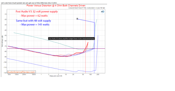

- 48v PSU makes you feel the power, if you are coming after other TPA3255 amps with 32v or 36v PSU

The official rating is 300watts at 4ohms but ASR tested the amp to be max 141 watts, that's less than half of the rated power. what's up with this ?
