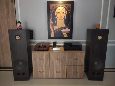

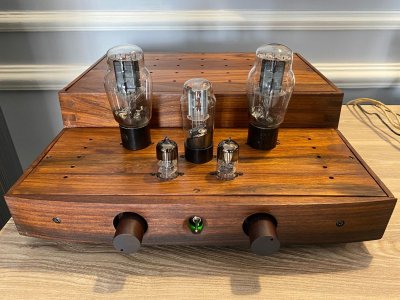

The Leak Amplifier makes way for a 2A3 amplifier made by Viren Bakshi. I have owned two versions of his 2A3 amplifier in the past. A 2A3 integrated as well as a full DHT pre-power.
The current version is the simplest of the three. It is a two stage amplifier with Soviet 6S4P-DR input tubes, NOS RCA grey plate 2A3 power tubes and Soviet 5C4S rectifier tube.
This is a brilliant sounding amplifier and I prefer this over all the Lyrita 2A3 versions I have owned / heard in the past.

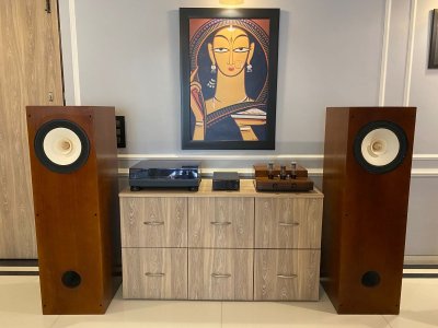

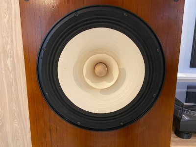

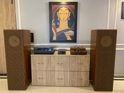

My speaker setup is now complete. Here are a few photographs.
It's a single driver speaker, using a 12 in Alnico wide band driver manufactured by Ishtvan Varga of Sonido, Hungary. A very knowledgeable and helpful gentleman making very nice drivers.
The cabinet was designed by me and masterfully executed by FM @sadik.
A big thanks to FM @prem for his constant guidance and inputs.
The speaker alignment chosen for this project is SBB4 that works very well with low Qt drivers like this one.
It's a very simple and musical speaker.
View attachment 88778View attachment 88779View attachment 88780
Simply a Wooow. A great audio composition and ideated & crafted by a pool of stalwarts. Your last statement says it all- a simple and musical speaker. That's the end objective which varies with the taste of the listener.
Not only that, this clutter free and soothing aesthetics bring peace of mind and less distraction during listening. The concentration is on music only. Lovely and some day I wish to visit and listen.

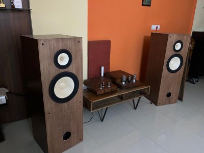

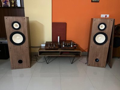

I recently designed a speaker for FM @Soulsatisfaction using a 7 inch Alnico Wide Band driver supported by a 12 inch Alnico Bass driver. The 7 inch Wide Band driver was placed in a sealed chamber of Qtc of 0.5 and SBB4 alignment was used for the 12 inch bass driver.
The drivers were made by Ishtvan Varga of Sonido, Hungary and the enclosure design was executed by our very own master craftsman @sadik.
The crossover is as simple as it gets, a single capacitor and an aircore inductor.

Thanks Satyaki and Sadik for helping me in creating these beautiful sounding speakers.
Puting words will not be enough but I can say it’s meditation for me listening these speakers and one must listen the musicality of these speakers.
With my Lyrita 300b full DHT amp these are creating magic.
They are very easy to drive speakers.
Someone looking for to have feel of these speakers can come to my place in Bangalore.
These are quite big and big sounding speakers. I am enjoying listening.
