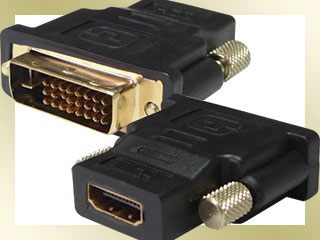

adapters exists ... as we can see below ..
I am currently using this. My htpc outputs dvi-d. I am using a DVI-D to HDMI adaptor and a HDMI cable to connect to panasonic pv8d. works like a charm.
