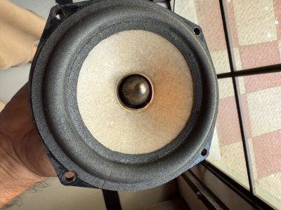

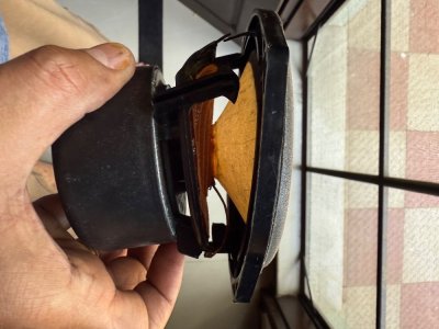

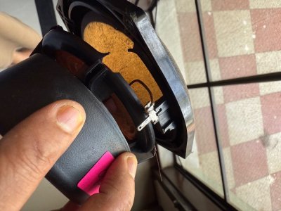

Hi All,
I own a pair of Mission 782 speakers, and unfortunately, one of the mid-woofers has been completely damaged. I had lent the speakers to my brother, and due to mishandling, the mid-woofer is now beyond repair.

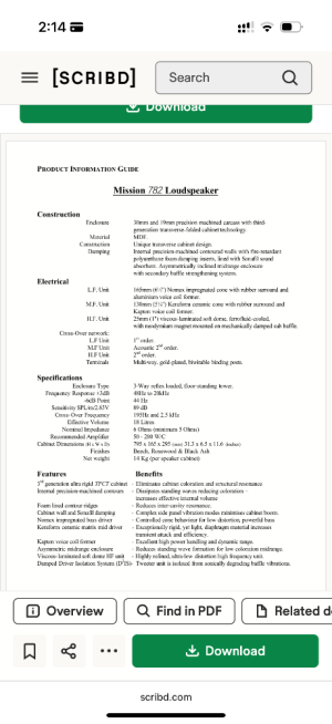

I am currently looking for a suitable replacement mid-woofer. I've attached the spec sheet I found online for your reference.
If anyone has suggestions on where I could source a replacement or knows of a compatible driver, I’d really appreciate your help.
Thanks in advance!

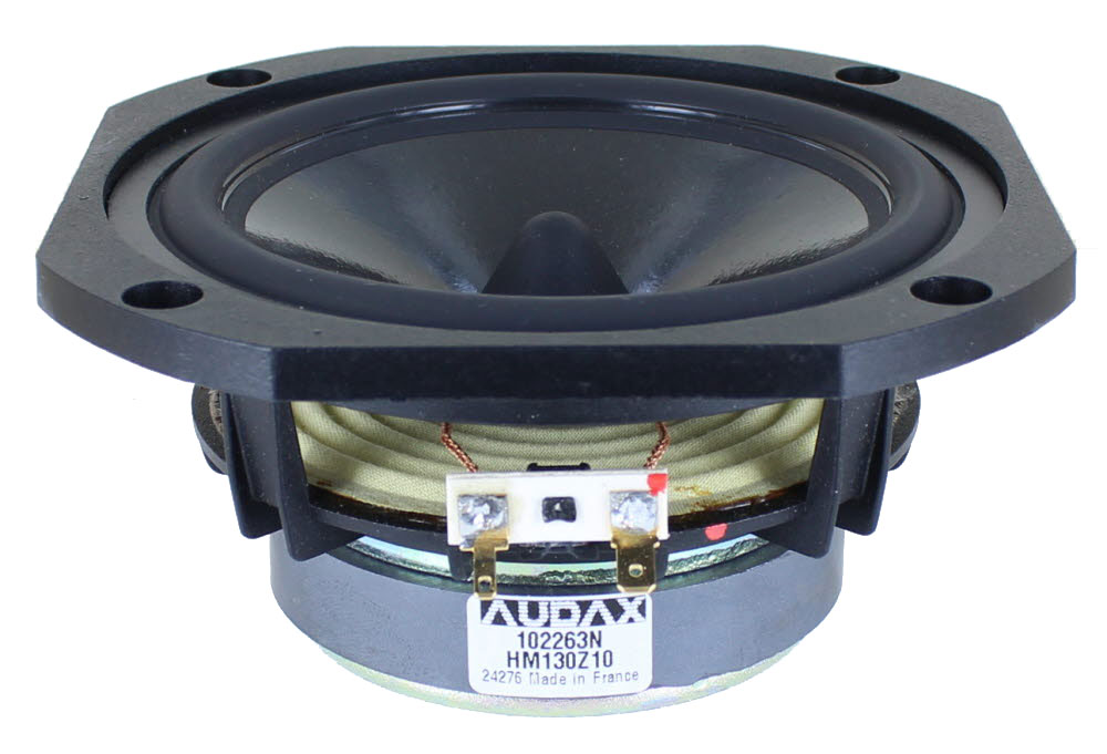

sorry to hear about the damage. I can understand how terrible it feels. While the original Keraform drivers are close to impossible to procure. There is a drop in replcement from Audax itself, called the Aerogel HM130Z0. It is basically even the same frame and mounting screw arrangement. I found them available on the below site , in case you want to check them out.
Apart from the above, there is a much superior driver called the Aerogel HM130Z10, this has better clarity, though the frame is slightly thicker than the original. But it is still a drop in replcement for your driver. However, you will have to buy a pair to change both the drivers, to maintain evenness. Below is a link to these drivers on Madisound in the USA. All the best :)

Glue it together; no need to replace. Cone looks okay in the picture. Or, there is something that I am not seeing clearly in the picture?
