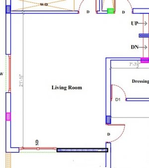

Can you all help me to set up a Home theater System in our 2nd living room in first floor.
Room size 21' X 14"
Has two windows..
Has two door entry to bed rooms.
I have optoma Projector and Yamaha RX v673 7.2 Amp. Will upgrade later to 5,2,4 or 7.2.4 system.
Only getting speakers now.
Budget around 3 to 4 lakhs for speakers.
Looking for good Inwall or onwall speakers
Kindly help me in choosing a good set of 7.2.4 speakers.

The mainstream in/on-walls might not be great for your room size, sir. Probably, the Dali M375s or the XTZs just might work...
You might have to look at something like this: https://www.qsys.com/products-solutions/loudspeakers/cinema/screen-channel/2-way-passive/sc-1120/
or this: https://www.aia-cinema.com/passive-speakers/ccm10-p.html
Both must be within your budget.
And go with an acoustically transparent screen.
