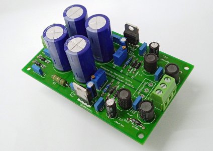

Hi all,
Finally assembled power supply for this Phono Preamplifier. Some pictures. What a beautiful PCB design and circuit. I am turning in to big fan of Sachin and Oms work. I hope someday they make SE tube amp kit. :)
The Power supply is half finished (I envy those who work 'fatafat' and make beautiful amps, speakers etc.(In other words I am Lazy :p) I need 12-0-12 transformer for this. I did visited Lamington Road and transformer was well made (Rs. 250) But total negative marks for finishing. Need good finish like this. The metal casing will be good (Though it doesn't sheild magnetic flux from spreading) OR will go for R Core transformer. Any pointers are welcome for R Core OR Well made + finished EI transformer.
Thanks and regards.

Joshua this will be put in casing with SE tube amp, and I guess 750mA will also do (Low foot print is what I am looking for). Kindly tell where can I get 12-0-12 R Core transformer ?
Thanks and regards.
Nice work Hiten bhai. Pics look so great. I have saved it on my computer. You can use Ei core without any issue, if you shield it properly. You van get the metal cover fabricated for the transformer.
Sachin
Thanks Joshua, Sachin and Keith.
I have sent email to 'Electro Magnetic Devices' plus two other R Core manufactures at Andheri. They are big companies and may not cater to single piece requirement. Lets See. Also it is in Ansa Industrial Estate, where I used to get my printing work done. So will be easy to travel and meet old friends.
Power Supply Photos : Joshua, Sachin they are taken from my humble mobile phone. I took numerous and posted which were clear. Sachin as forum has restriction on resolution of images I will mail high resolution pictures to you.
Regards.
Keith thanks for the list. I like this one. But it shows only two leads. Others are showing proper 12-0-12. Like this. Finish is also good compared to 'Soumik electrical' one. Lets see how R Core enquiry goes or will buy from the list you have provided.
Regards.

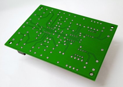

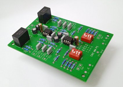

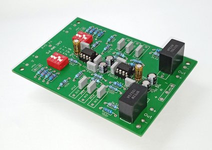

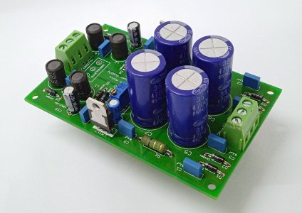

Hello eeryone,
as my my earlier phono preamp was fitted in Preamplifier (Link) and was sold I got new one from Sachin, Thanks very much Sachin. Sharing some pictures. This build has most quality parts, Nichicon, Vishay, Bournes etc.
Power Supply.
Text Book Soldering ...
Waiting for proper transformer. This is very easy build as Sachin provides all parts with proper lable.
