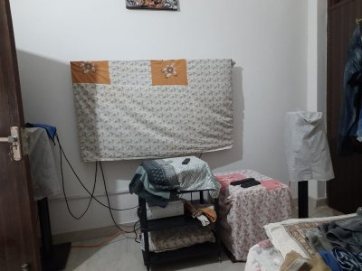

my room is small 13x11x10feet. i can put it in front only.
it is in front right but not in corner.
the position seems to be ok. But if you feel bass is still lacking , move the sub towards the wall more especially towards right corner ..give minimum space between your wall and sub. Move away step by step from wall if the bass is too boomy ..then find the sweet spot.

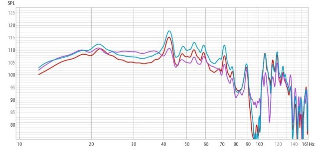

pb 2000 pro and 80hz and 120hz . I tried all positions on right side but graph in rew was roughly same so no need to change place.

see these rew graphs even if i push towards right wall its same exact graph. In front atleast i need to live with these nulls. Maybe some day will try right wall but need to remove my folding from room where i sleep

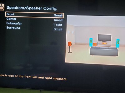

Sorry, I have Marantz avr. But the menus in Denon and Marantz should be similar.
1) In the Denon setup menu , go to speakers.
2) You will come to a submenu showing Audyssey and manual setup.
3) Choose manual setup and you should get this menu and set speakers to small.
4) Experiment with the different crossover settings. Check the phase setting later only if required.
Better to do one adjustment at a time since things could get confusing if you try everything at the same time.

I ALREADY KNOW . this setting is not there but you are saying i will check once again at 8pm today thank you. But what if this setting is not there whats next?
