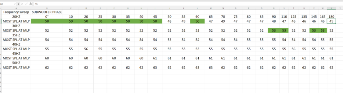

Till now measured till 50hz frequency sweep. But did not find much spl difference in other frequencies but 20hz. Is testing 5 increment in phase not required? Should i quickly test 0 35 45 65 90 135 180 phase? I have pb 2000 pro. i used spl metre in mobile

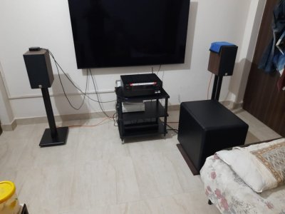

finally moved my bedding a bit and pushed subwoofer towards my listening position and guess what that massive null at 72 to 78hz has got better cant believe it but it has reduced to half but not fully need to see now in rew what dirac bass control has done to it. Now my sub is 56 from front wall. Only issue is i need to put it back again and again when i run my ht but will manage it.
