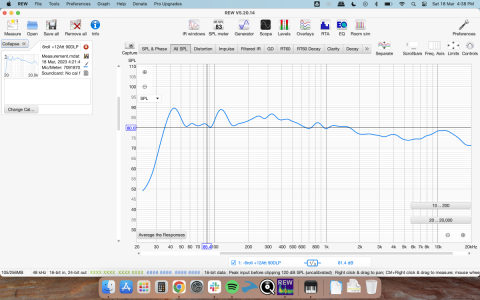

Next step in this journey was a bit of measurement to understand what is going on. I did take a lot of measurements and after fiddling with a few dip switches the following is what I got.
With the little understanding & experience I have - this was the best measurement I got after fiddling with multiple permutations & combinations & in the end - the phase correction to 90 Deg from 0 & -6Db roll off on the sub is what was needed. The rest is pretty much as is.
**Also this is perhaps the best sounding as well - maybe biased by what I am seeing.
**Just here to pick your brains on -
1 - What am I looking at?
2 - Is there scope for making this better? FROM an educational point of view, I can always revert to this.
Thanks!

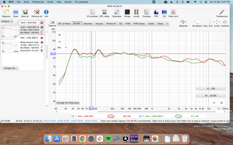

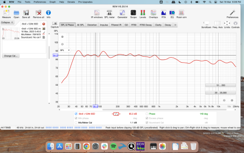

A couple more measurements with placement change -
Comparison with the previous one -
Please note - these are with just the dip switches and some placement - I haven't yet incorporated the RME ADI 2 in there for equalisation. Where can I expect to incorporate some EQ looking at these graphs? Based on my memory - PURELY - the flatter it is getting the more I am liking it. :)
Your FR graph looks decent. In fact, for home audio listening, this is ideal. A flatter FR is desired only in a studio setting for the mastering process and will sound bright, and not pretty!
A few things to note:
  1. An FR reading is useful to understand problem areas, and your graph looks fine.
  2. Smoothen the graph with 1/12, or at the bare minimum 1/6 for any meaningful depiction.
  3. A problematic peak can be tamed with your RME PEQ.
  4. Nulls or dips are suck-outs, and cannot, and shouldn't be attempted to be corrected with EQ, it'll overdrive your speaker and lead to distortion or damage. The only way to sort or nulls are via speaker placement or room treatment.
  5. A 5db variation in peaks and nulls is fairly acceptable for home audio.
  6. If you're genuinely enjoying what you're hearing at the moment then do not adjust any EQs. The slope which you've from 1k onwards is not only desirable, but ideal for a fatigue-free listening session.

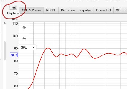

Tip: use the capture button to save a screenshot of the graph.
