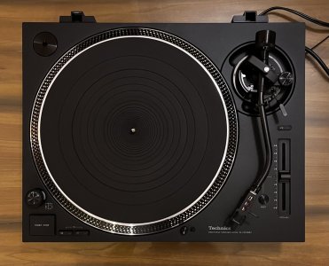

Here’s the deck assembled out of the box.
I chose the GR2 as it’s loaded with all the features I was looking for; plus a few I didn’t know I needed, but was delighted to discover.

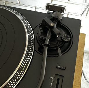

VTA adjustment dial - Turning a dial to adjust tonearm height is far simpler than loosening some screws and physically pulling the arm up or down. The dial lets you focus on a VTA block and eliminates any trial and error shenanigans. You can even make changes while playing a record, if you prefer to adjust by ear.

Super-easy cartridge alignment - Technics provides a simple plastic gauge to set your stylus overhang. Get this right and you’ll hit the null points on a protractor without any problems.

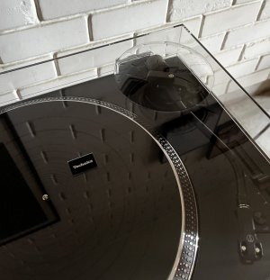

Excellent dustcover - I always remove the cover when I’m playing records, so easy removal and refitting is an important consideration. This one works smoothly, plus the VTA bubble looks cool.

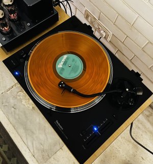

Strobe light off option - Unlike the 1200/1300Gs, you have the option to turn off the bright blue strobe light while spinning records. When enabled, it comes on when you start the platter and switches off once the speed is stabilized; which is pretty quickly.

No azimuth - The tonearm lacks an option to fine tune azimuth. You’ll have to finagle the headshell while mounting on the arm, or get one that has azimuth built-in.
