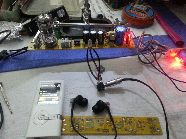

This amp shows possibility to be used as a preamp.
When I connected to DAC, sound clarity was good enough.
Now I am going for casing.

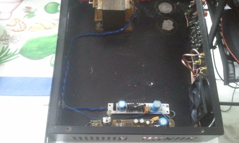

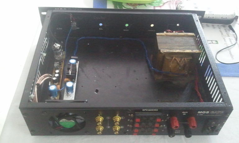

Shameful for old case and poor setting!
The house is too big, and amp is small.
But it was done only for removing white noise.
After putting into the case, almost no noise is found.
The next step is aging and testing as preamp.

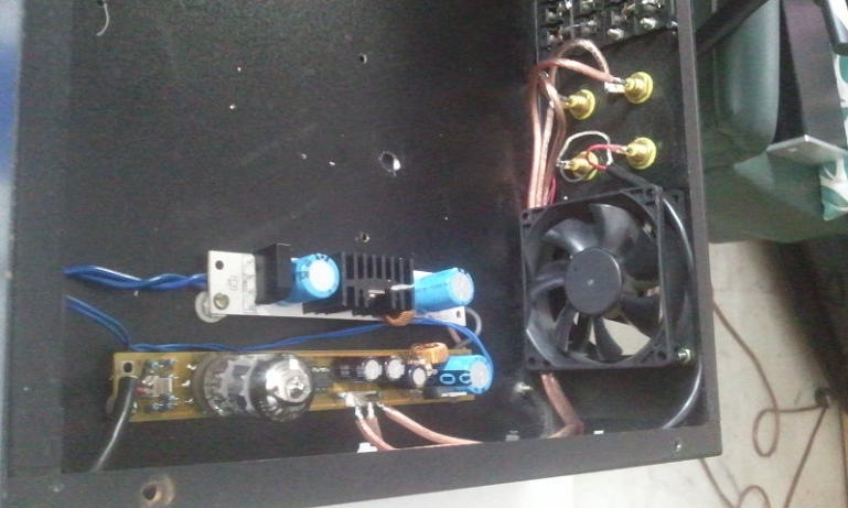

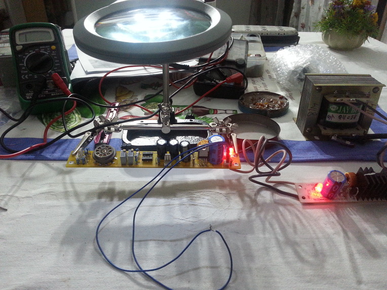

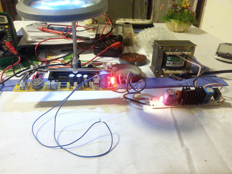

After some tuning, there are some improvement.
Voltage to OPAMP was 12V.
It was supposeed to be 14V.
(When I put the amp in the cabinet, it might happen
or the trans that I have changed caused low voltage to OPAMP)
Soon after adjusting to 14V, I could hear the sould that I have longed for.
As a headphone amp, it is good.
Now I am going to connet this amp to main system(power amp).

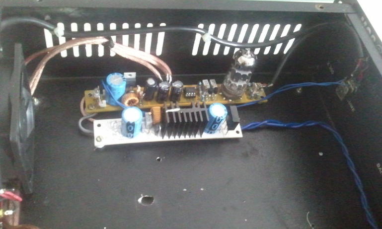

What did you do to eliminate the noise?
1st Casing : Big & Ugly Cabinet is only for reducing the white noise.
As you see, tube amp is far from transformer.
After putting in the cabinet, noise became less
2nd Earthing : PCB to the Cabinet and Cabinet to earth
After earthing, noise became much less.
Now I can not hear any noise in 50% of volume.
I am listening Music in 30~40% of volume.
In the Maximum Volume, there are little bit of noise.
