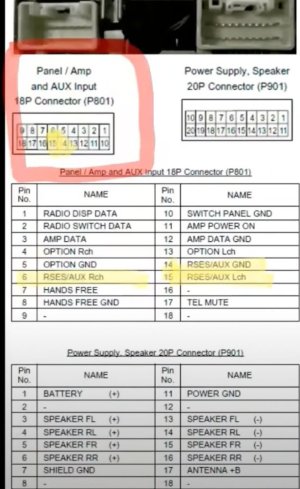

Just an information on how to add the aux cable to your Mitsubishi montero/pajero with the Rockford Fosgate head unit.
Video on how to solder on the aux cable:
