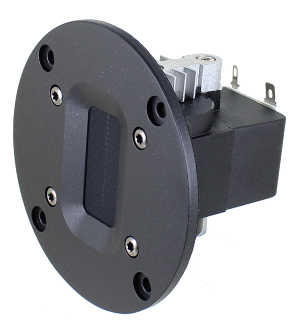

The RAAL (and most other ribbon and folded ribbon tweeters) is an acquired taste. I say this with the disclaimer of having used the RAAL 70-10D and 70-20XR, Fountek NeoX 2.0 and NeoCD 3.0. They have some limitations in vertical dispersion. The Fountek NeoCD 1.0 is not as limited. You can check out the Neo CD1.0's dispersion curves here:
FYI, the Mundorf AMT U40W1.2-C (perfect if used with a small midrange above 4k or so) is on sale at Madisound. Other interesting drivers are the Purifi Audio PTT8.0X04 (woofer) and Purifi Audio PTT4.0X04 (extended range mid-woofer). The latter is also on sale at Madisound. I think a pair of PTT8.0 combined with a pair of PTT4.0 and a U40W can make an interesting WW - MTM system. Food for thought.
