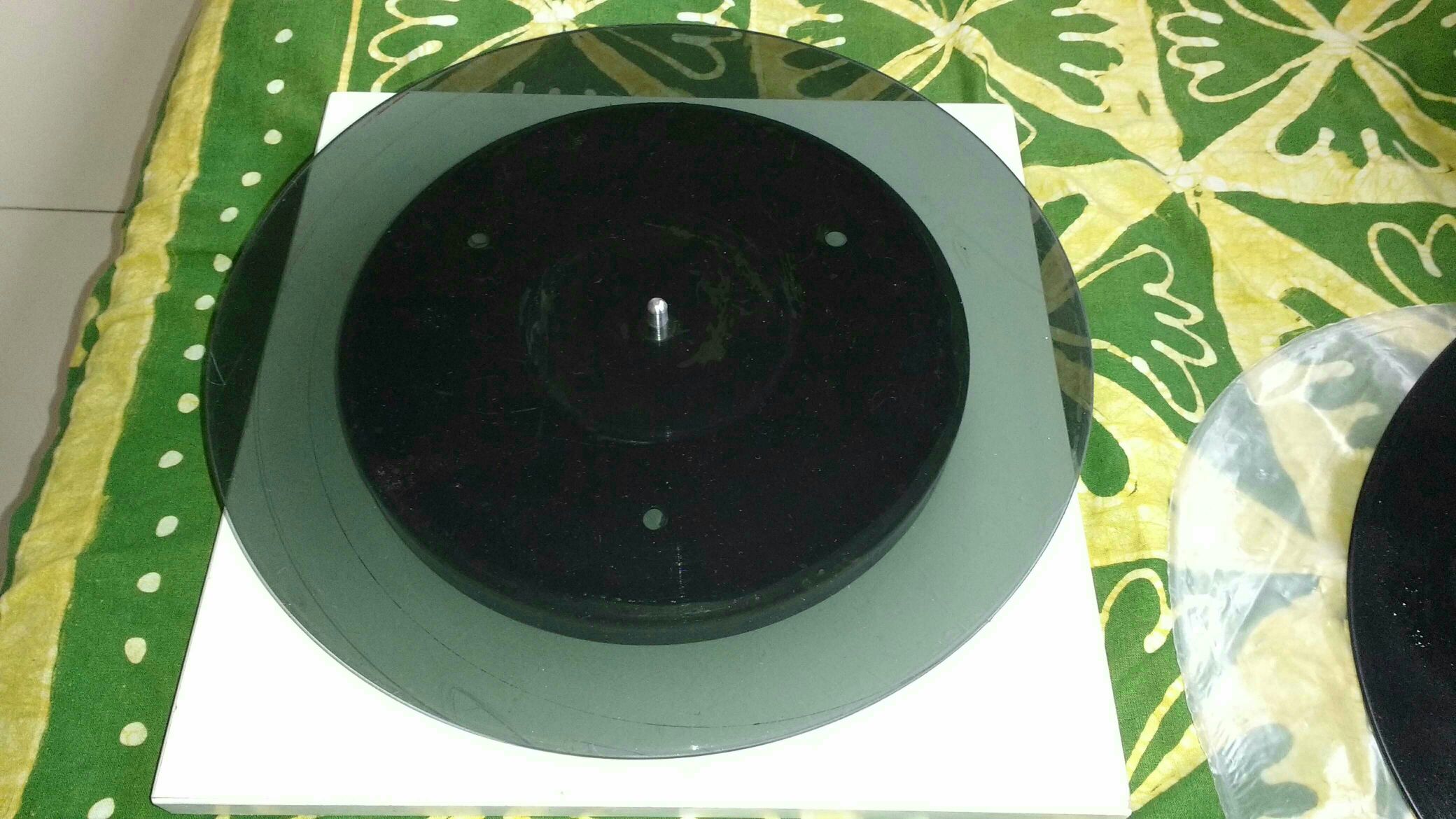

Hi, want to share DIY record cleaning table.

Looks good, can you please provide the details regarding how you made the spindle bearing assembly and platter. Thanks.

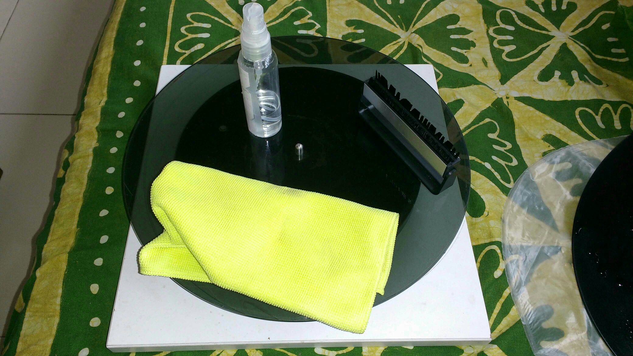

Thanks look good,could u provide more details please regarding the brush and the cleaning liquid.
Base is plywood, spindle and platter is from old damaged hmv turntable which came with record buy.

Keep it up. Brilliant idea. If you can make vacuum jig attached then it could be automatically spin and suck the dirt.
Very soon I am going to build vinyl cleaner TT. I am getting a working TT (but may be tonearm has any issue). I will change the motor to any faster one (more RPMs, 100+) or put that motor under platter directly (with DIY skills). Will put cleaning brush on tonearm. Let see how it goes.... (Finger crossed).
Brush is carbon fiber. Liquid is distilled water 3 part and isopropyl alcohol 1 part. I will put together build details soon. Omishra just gave good idea of adding vacum, planning to buy 12v wet dry vacum and add to it.

Thanks a lot, what exactly is iso propyl alcohol? Can u walk into a chemist and ask for it? Also any particular make of the carbon fiber brush u use?
You dont need to change the motor for speed just reduce the size of platter diameter it is driving. However I guess cleaning liquid will be thrown out at 100rpm. Instead of speed you need more torque to clean the record with big brush on it. You can use geared motor used in robotic kits. I guess they are DC so speed can be controlled. Take safety care if AC motors are used. Tonearm also serves no purpose unless you are making vacuum cleaning machine like Keith Monks.

Actually what I have in my mind is... I will make the platter spindle like bolt with threads (Chudi), after putting the record.. I will put custom made label saver and tight that with nut to keep the label dry. I want to put all these in custom made deep cabinet, which will keep the internal parts safer.
Available freely in the electronics parts market. Used for cleaning purposes. Typically Rs 50 for a 500 ml bottle. Should be cheaper in the Industrial chemical market but minimum quantity could be 1 liter. Often labeled as IPA .
What I have is isopropyl rubbing alcohol USP. It's a clinical spirit that I got from the chemist. 100ml bottle cost rupees 33.

Where can I buy carbon fiber brush for cleaning vinyl records? Still now I have been using baniyan clothes for cleaning my vinyl records.
