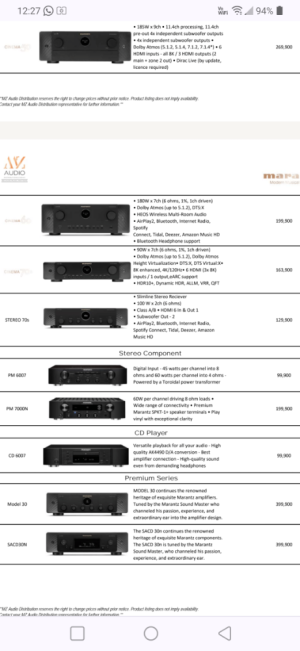

The brochure says 90 watts
Then what does 90 watt per channel mean?
It means 90w if you have a single speaker connected in this case. A lot of AVRs quote 1 or 2 channel driven specs unfortunately. Try and find the all channels driven spec for whichever AVR you’re looking at
Unfortunately among the mainstream avr's, only Nad honestly specifies all channels driven @ 8 ohms.

I've looked at the measured performance of older Marantz slimline AVRs for this heuristic. Thats why I framed it as a guess
The 90w figure is what individual channels can deliver performance on assuming the power supply keeps up. Generally the power supply is the constraint. Divide power supply by no of channels to get actual power. For eg, the Marantz 1510 has 210w of power draw for a five channel amp. That lines up with measured performance.
Generally, 50w per channel is enough unless the speakers are particularly difficult to drive
