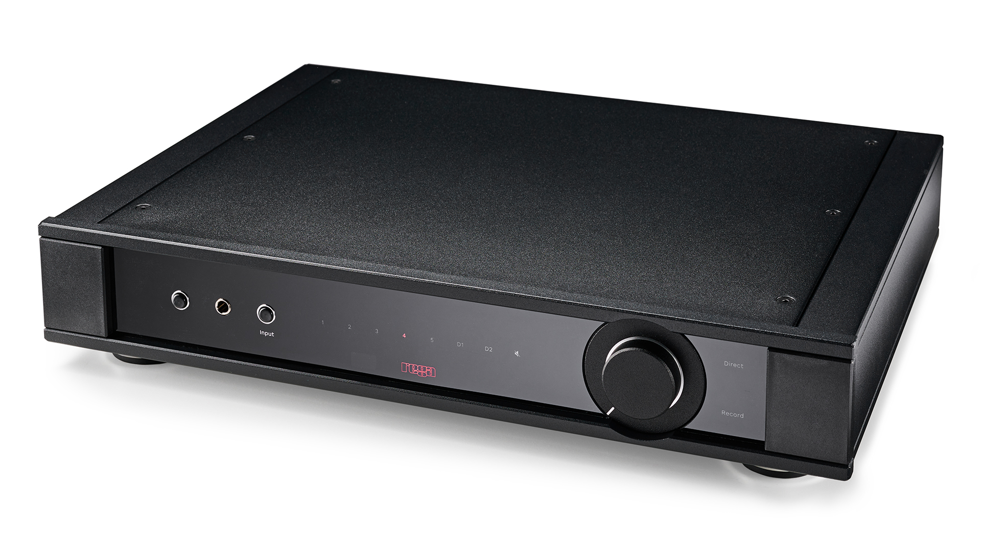

Read this ...maybe this amp will work for you .
I have not heard this , but also looking for amp which is forward with vocals and slightly more treble - not warm or laidback .
Check Rega products and audition them if you can . Norge which I am using currently is better than marantz in this department .
