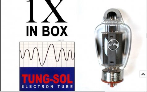

1) What is the best sounding tube amp you can use with them, ........ always .......priority one.
( Likely, I would use the single new and well-received KT170 "Elegant Edition " tube. Have a 6E6P-E directly coupled into it. Just two stages, DCed, Single Ended, LSES supply. ) Wow !
