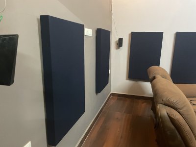

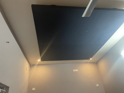

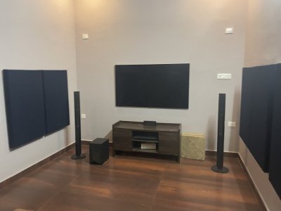

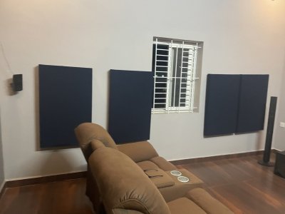

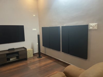

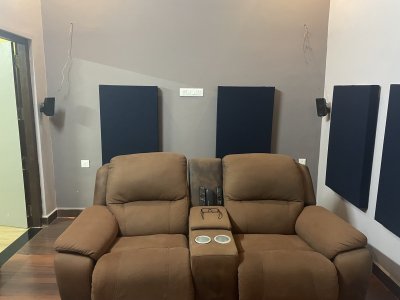

Hello All
I'm new to hifivision but always have been great fan of music and audio. Now I'm into one of my biggest dreams of building a dedicated home theatre. It has been a year since I started after completing the construction of my house.
Room Dimensions: 10.5 ft(W) * 16 ft(L) * 11 ft(H)
Visual: I didnt like projectors as I prefer picture quality than size and I couldn't resist the clarity of OLED's. So bought a LG G2 65 inch TV last year which is wall mounted.
Room Acoustics: My room is not yet fully treated with acoustic panels, but I'm making DIY acoustic panels iteratively, will stop when I feel the sound is not improving anymore. Yet to start building the bass traps. Currently I have enough panels to watch movies with clear sound reproduction with out lot of echos. Only problem is low end reverbs. Will add bass traps to all the corners soon. Yet to put carpet(only if needed after filling the room with enough panels, if find a need to still reduce echo's, i'll. As I have a kid playing in that room almost all day, he used to spill lot of stuff on the floor and carpets will make cleaning a nightmare). I didnt go for full room acoustics as I've a tight budget and not interested in spending a lot on looks and asthetics of the room.
Current sound system: I have a sony HTIB system BDV-E4100 bought 7 years back. Using it for time being. Plugged it to TV and leveraging TV's streaming capabilities which I'm intending to continue to use even after setting AVR for sometime until I get a dedicated player such as NVIDIA shield TV PRO.
Couch: Have an old recliner, need to replace it later.

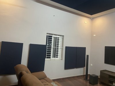

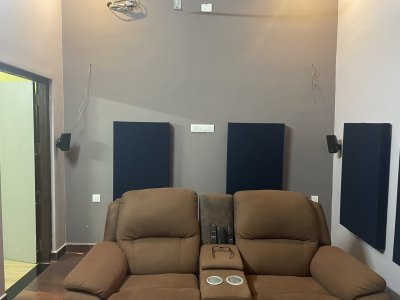

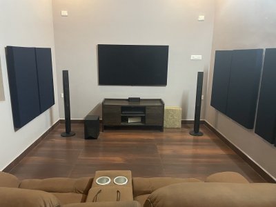

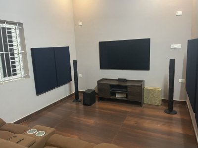

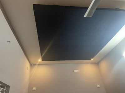

Attaching the current photos of the room here:
IMG_5713.jpgIMG_5714.jpgIMG_5715.jpgIMG_5711.jpgIMG_5710.jpgIMG_5709.jpgIMG_5708.jpgIMG_5707.jpgIMG_5706.jpgIMG_5705.jpgIMG_5712.jpg
As I continue to improve the acoustics by adding panels and bass traps, I decided to buy sound system AVR and 5.1 speakers to start with and add atmos speakers after a year or so. For the dimension of the room I believe 5.2.2 layout is more than enough. Please correct me if I'm wrong or adding surround back provide more value.

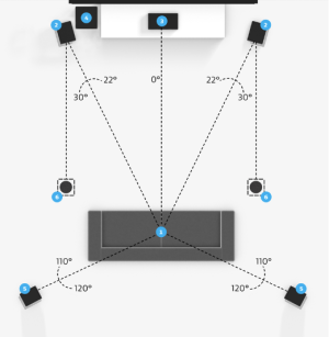

The current thinking is placing the surround speakers slightly behind the couch (as it is mounted currently) just to avoid very close proximity of speakers for one seat in the couch. That's y adding another pair of surround speakers would be problematic. Considering a layout like the below one:
So thinking about getting a 7.2 channel receiver. Please suggest me whether I should consider 9.2 instead.
My budget is around 1.5 lakh(already spent 70% of my overall budget in TV :( fell for the stunning brightness and color depth) for both AVR and speaker package. I prefer better sound quality over more number of channels in the layout. But if adding more channels improves quality, then I would like to consider that.

Regarding other questions, I'd suggest 5.1.2 will be the sweetspot for your room size.
There's not much for even the surrounds to do in my experience, and rear surrounds will not make much of a difference.
Speakers, I'd suggest a high efficiency bookshelf + centre or LCR wall mounts.
And yes, a claimed 80w per channel with two channels driven is kind of enough if you dont go too loud. (65-75 dB)
