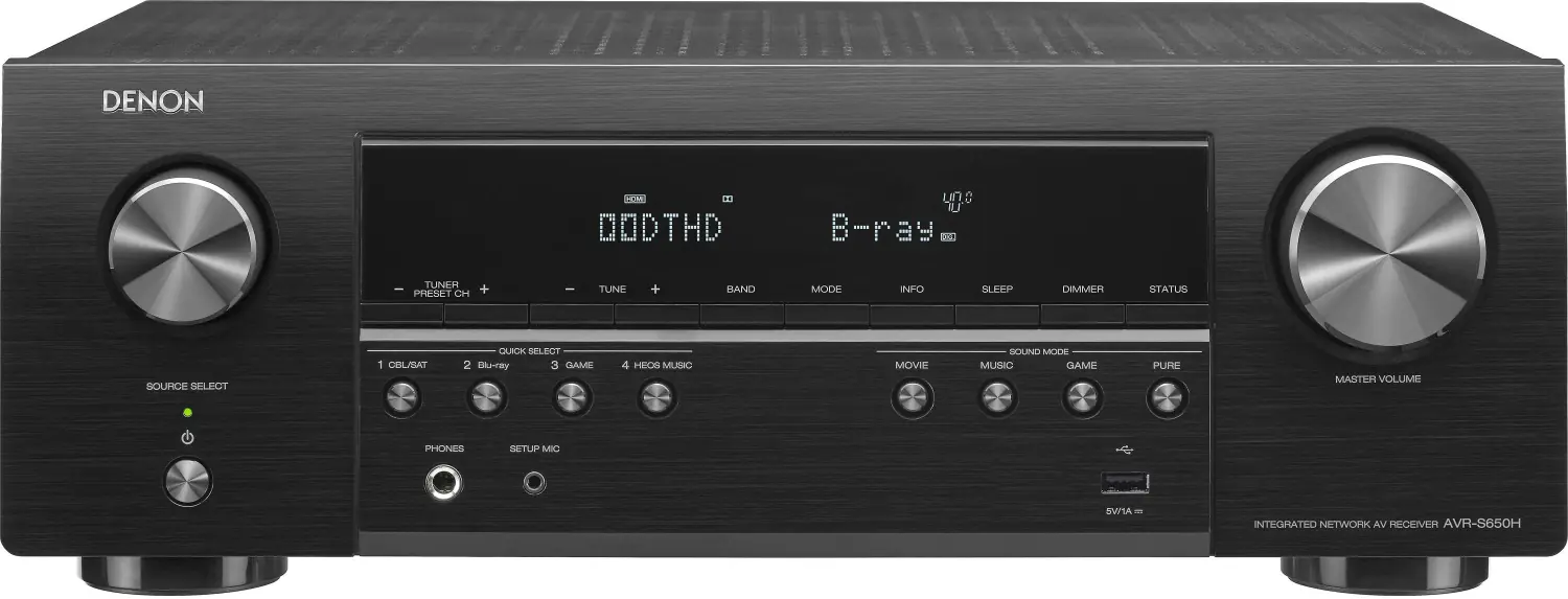

I'm getting new Denon S650H at around 40k, should I consider it as an alternate choice over 1400H/1600H? I don't have much idea about the difference between S and X series.

The S650H seems to be a good buy at 40k if you cant get hold of a 1400h/1500h at a similar price. Power spec wise seems similar to the V485 though but the presence of MultiEQ XT adds good value, also there is no 4k upscaling in the S650H which should be fine unless you are going to use it with a 4k display anmd intend to upscale lower resolutino content.

Its a good deal to get 650h for 40k but it lacks in Audyssey multieq.

650H seems to have MutliEQ as per specs, the X250BT/550BT both dont have MultiEQ
