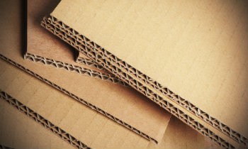

I found these by googling “cardboard and acoustic treatment” There seems to be a rather casual attitude towards the distinctions between sound proofing and acoustic treatment though
Cardboard acoustic panels can help reduce the transfer of noise by up to 40%. They can be hung on walls, attached to the ceiling, or suspended from the ceiling to provide noise absorption away from wall areas. Those suspended from ceilings can also act as baffles to help reduce the echo within a room.’
