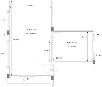

Next year, I will be moving to my own home. What kind of home theatre can I setup in the space that I have?
Jagadeeshr
Jul 11, 2022
2
1
Two available locations: living room or spare room. The living room will be 13 feet wide, 24 feet long , and 10 feet tall. The spare room will be 12 feet wide, 9 feet long, and 10 feet tall.
I have zero experience with home theatres, so these are the questions that I have.
I. Location
Which location would be more suitable, living room or spare room?
II. TV size
No matter where I put the TV the max distance between the tv and couch will be between 9 to 13 feet. At this viewing distance, what size would be ideal?
III. Audio
Since I have no experience setting up a home theatre, I would like to start with 2.1 and then expand to 5.1 or 7.1. Initially, can I just buy the receiver, sub-woofer, and 2 speakers. After that add more speakers.
IV. Connecting Speakers to Receiver
How to connect the rear and side speakers to the receiver? These speakers will be far from the receiver, how to run the cable between them? Just running them along the floor doesn't seem ideal.
V. Brands
If I setup a home theatre, I will not be upgrading it for atleast 10 to 15 years. Is it better to go with a big name brand or any alternate brand that offers the same features at a cheaper price?
VI. Changes during House Construction
Is there anything I can include during the house construction to make it easier to setup the home theatre. For Ex: Audio outlets in the wall to connect speakers, size and location of windows/doors, etc.
I. Location
You will have more freedom to do what is required to set up a proper HT in the spare room, so spare room it is for me.
II. TV size
Get the biggest screen that you can afford. With quite a lot of HD content, seating distances of 8 feet for a 65 inch TV is quite normal.
III. Audio
Of course you can. I would a plan a 5.2.4 if I were you.
If it is a room under construction, run the speaker wires through the wall via a pipe. (Concealed in-wall wiring)
V. Brands
Get the best receiver that you can afford which will support 5.2.4 channels.
Most certainly. Plan in-wall wiring and outlets at the stage of construction.
https://www.dolby.com/en-in/about/support/guide/setup-guides/5.1.4-overhead-speaker-placement/#gref

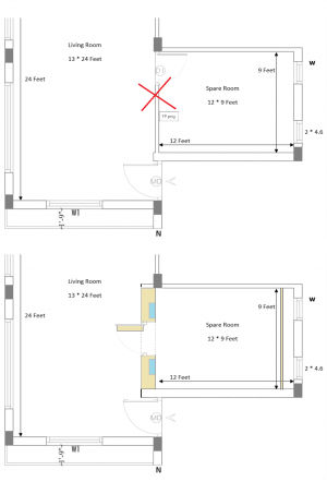

The living room is the best among the options as it is bigger in size but has lot of limitations for acoustics as we have big windows at one side of the wall.
I would choose the spare room as it has better options when you adopt proper treatment methods. The only issue is that we cant have many seats as the room size is small, only 1 row is possible (2 seats or a custom built 3 seater Max). Bean bags can be used for extra or temp seats. However in the living room also we cant have more than 1 row of seats as we cant have a theater like seating arrangement. So seating options are same for both the rooms.
Another issue is the acoustics limitations of a small room. It will come up ONLY when its a CLOSED small room, for that I would have done the following:
- Keep the rear portion of the spare room open
- Acoustic transparent False wall (marked in yellow in the pic)
Extend the two side walls 1 - 1.5ft into the living room and build a false acoustic transparent 1ft thick absorber wall with the door at the middle. This will act as a 2.5 - 3ft thick absorber as it has infinite open living room space. The low freq is reflected back if we have hard walls and corners to accumulate them, but here it will absorb a good amount of low freq. The inner and the outer surfaces of the wall can be fabric stretched to give a wall kind of look for aesthetics.
The rear diffusers (marked in blue) can be at either sides of the door on the spare room side and for the living room aesthetics a showcase or a display unit right behind this area can be made. Rest of the wall is acoustically transparent and acts as an absorber. This completely avoids the closed room issues (corners) in a small room, now its acoustically a big room.
- This is a good candidate for a Single Bass Array design with 4 custom built subwoofers mounted on the infinite baffle wall (along with the LCR speakers) behind the screen for consistent bass for all seats.
- Usually any theater build starts by finding the best seating locations of the room and rest of the speaker locations, screen size, acoustics etc are dependent or developed based on that. Since the rear is open we cant exactly predict the room modes' location and since this is a narrow room, we need to do in reverse. So the screen size can be the max possible, 8.5ft min, if possible the entire 9ft width without any edges, it will give ~115 16:9 screen. Eventhough the room mode locations cant be predicted exactly at the initial stage for the seating locations, it will be somewhere ~8.5-10ft. So this screen size will be well within the proper viewing angle. Later the seating location can be fixed by proper acoustic measurement of the room.
- The projector (if reqd) can be either installed within the rear false wall or a hush box can be built in the living room side with proper throw distance for the screen size.
- All the equipments can be placed in the living room itself so that we get the max space inside the spare room. It will also isolate any kind of noise from them.
Apart from that with proper spread of absorbers, diffusers or absorber-diffuser combo on the side walls we can make it sound bigger.
