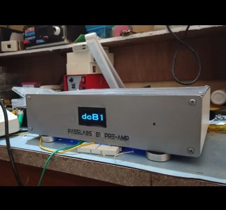

How do u do a pass B1 without buying chassis?
Diy way 😄
Some metals were cut with hand tools
And sides 2pc wood was used. this thread aims at low cost build of the preamp with least of the expansive material.

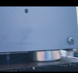

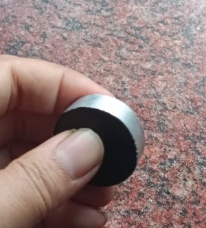

The feet : metal feets look good plastic chromes are 150/-
Diy version is 2/- material and 30min time
Procedure take strong bottlecap. Slice half of it to keep height 1cm .
Plain sheet aluminum u have to cut and make a thin section just to attach to outer of cap.
Make ur idea to lock in.. U caan insert ends to the cap or rely on glueand tape overnight.
Use araldite.
More pics of chassis feet. diy I did as it's fun..

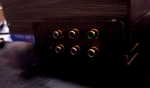

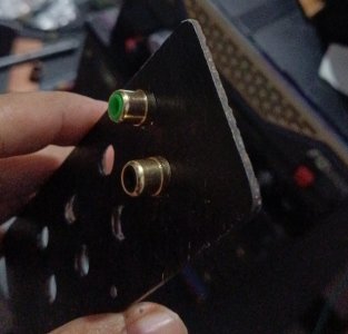

Too lazy to order from reputed sites. But few chassis hardware are from websites like
Gold rca sockets
And wires and Perfboard strong ones
Rca inputs planned 4channel in but gold rca was 6pc with supplier. More Rca female will arrive. Strong ebonite used to fit. I wanted to avoid Gnd to touch chassis. This will be attached to metal chassis with tiny screws
