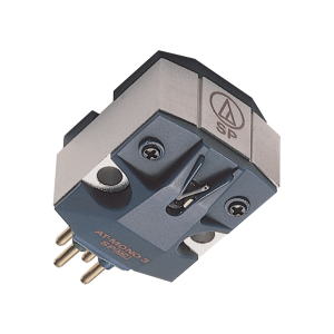

@reubensm , I ended up replying to your inputs on #35, in @General_sound inputs.
Please go through it and if you could discuss the cost vs benefit of paying the price of AT Mono03, a Moving Coil on AT120 for 78rpm Shellac as opposed to playing 78 Shellac on GC 032 idler wheel drive TT with its 78 selections?
I see everything seems to fall in place with AT120 and this mono cart. Right tool for the right job. Direct drive, a dedicated cart and stylus. I am not too sure, but the cost of his cart is somewhere upwards of US 180. It is available at very few stores but not with Audio_Technica. Original Japanese mfg.
The cost in India is over INR 33k https://www.desertcart.in/products/...p-mc-type-moving-coil-mono-cartridge-japan-im
The cost in some stores across the world is about USD 200 (Plus cartage charges and duty as applicable).
The AT LP120 TT with Headshell, Cart, stylus, USB and Bluetooth is about US 400.
I am not sure if there are alternatives which could be in MM and go with At LP120 Tonearm Fitting. Whether the HS6 headshell itself have a compatible cart to play Shellac 78 records, is also not known.
Do give it a thought please.
Solong
Cheers
Solong
Cheers
For a start, if I were to play 78s, I would definitely go for a mono cartridge as they somehow seem to be more forgiving when it comes to groove inconsistencies, surface noise and turntable rumble. The key to owning a 78 collection is to know the usage history of each record. This is close to impossible especially if records are purchased from shops or vendors. From my experience, magnetic cartridges for 78s produce better sonics but are very sensitive to groove distortion, groove and surface noise and if your 78 happens to have a deepish scratch or a slight crack, a cracker would burst through your speakers each time the stylus runs over it. A mono ceramic cartridge preferably from the likes of Sonotone (if you have access to international markets) or HMV, Philips and EEI if you are looking to purchase in India, is the best option. A flip stylus with microgroove on one side and 78 on the other gives you the option of using this setup for playing very old and worn microgroove records as well. Ceramic cartridges sound bad as almost all contemporary users are not familiar with how to connect them to an amplifier. One would require a passive input impedance balancing network (with a slight loss of gain) or a dedicated phonostage (without loss of gain) for excellent sound quality. For playing 78s, a scratch filter could be useful or if you are building a DIY circuit for the purpose, using variable cartridge impedance loading can control the noise to some extent as illustrated in this circuit (the variable resistor VR between the cartridge and the circuit serves the purpose).
PS: It is a complete misconception that ceramic cartridges damage your valuable records. Yes, they will if they are used on cheap turntables with heavy-weight tonearm tracking, and with misaligned, worn or damaged stylii. The routine of appropriately setting the tonearm calibration, caring for the record and stylus, and more so, careful handling, is essentially the same for both magnetic and ceramic based rigs. A true tonearm with accurate tracking can handle ceramics easily with 4-5g VTF which is similar to some magnetics. For example the Shure M3D MM cartridge tracks with VTF between 4-6g.
