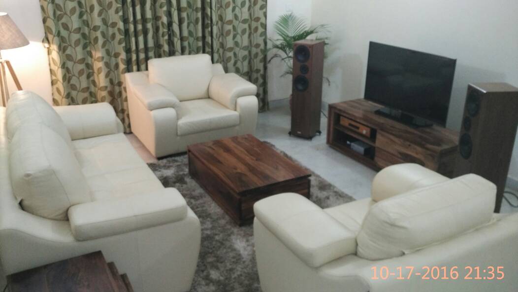

I am planning to set sound absorbing foam on back wall, which is about 12 feet from my speakers front panel.
I dislike the look of acoustic foam. I have planned to print 2x3 feet canvas of some landscape photographs on canvas prints that I captured during travel. In fact if I put three such canvas prints it will cover 6x9 feet of my back wall. But it may not be continuous cover, there may be some gaps between each picture. I will frame this canvas prints on top of the acoustic foams, and off course no glass or cellophane on top. The frame of these pictures will be made of hard paper cardboards.
In stead of canvas prints, i can go for a very large Madhubani painting or Rajasthani painting. Canvas photo prints may have oil varnish which may prevent easy sound absorption. I think the best bet is something like katha stichting art ... stories narated by sewing threads and stichting art work.
Please let me know what you think if this will help.
For reference here's my room.

I have got 5x7 ft shaggy carpet today AVIRA HOME BEIGE SHAGGY CARPET-5x7 Feet https://www.amazon.in/dp/B015CW0Q22/ref=cm_sw_r_cp_apa_1ypbybH7BWSRZ , placed it 1 ft away from speakers, and it ran till my sofa.
I listened to male vocal, guiter, drums and I find the sound now has little less brightness, drums sounds are more strong, cymbals brightness is reduced and little more warm. I liked it. Listened for about 2 hours, and the sound is more comforting now to my ears. I had to turn the volume about 10% more, to hear the details in low frequencies which was clearer without the carpet. For the first time my neighbors complained :)
Anyway, I guess for now I will stay with the comfort listening that the introduction of the carpet has brought. I may not be able to turn the volume to 40% though, 30% volume on 75 watt 89 db sensitivity of AP amp in my 14 by 22 ft room is good enough.
