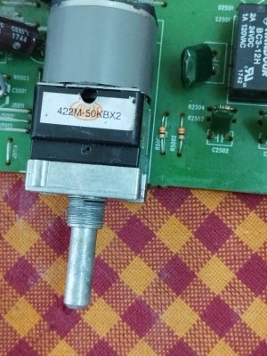

Can you put up a picture on where it's located . Does it have a daughter ( small ) board of it's own ?

Thanks a ton for the details explanation. I will try cleaning this first with a help of a service person (the problem is there is no proper authorised service person in Chennai so I was hesitating to give it to anyone else to clean it before I know for sure if 100k would work if I have to replace it eventually. And to your question on the separate PCB, yes, the motorized pot is on a separate PCB but that is not small and has other components as well. Attaching picIMG_20190921_130606.jpg

Success!!!!! I removed the pot from the PCB and opened it... Found the track and contacts....cleaned it with earbuds without using any liquid...and soldered it back! This has done wonders to my amplifier!
