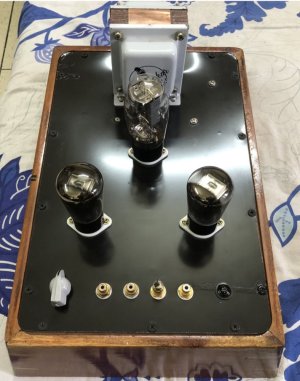

DHT preamp crafted by me, Re084, rectified by DHT 1805.
@yogibear , Thanks. That preamp looks lovely! There is a lot of talk about the beauty aspects of the DHT sound!
However, technically speaking ---- Are there any benefits in terms of transparency and resolving capability if you go the DHT way ? In case there is, can you elaborate on that a little. No pressure....Just whenever you find some time.

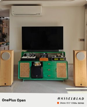

I have moved to a all DHT pre/power amplification. If the speaker is up to the task, this is one of the most beautiful sounding amplication money can buy. Low distortion. High resolution yet somehow sounding pleasant and musical.
