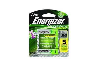

Energizer Recharge Universal AA
A top-performing AA battery
Among the top-performing AA batteries in our testing, these kept a flameless candle flickering for 120 hours and a remote-control car running for 16 hours.

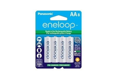

Panasonic Eneloop AA
Slightly lower performance but a longer shelf life
Among the top-performing AA batteries in our testing, these kept a flameless candle flickering for 120 hours and a remote-control car running for 15.5 hours.
