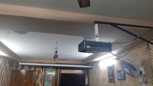

Can you please advise where I need to install atmos speakers of second set.
Thinking of some where above the projector.and on the wall rear xurrounds
The Atmos ceiling speakers have never worked for me except in very few scenes. Maybe, their angle of placement is way off, or there isn’t a lot of heights effects mixed into movie tracks.
However, when I moved from 5.1.4 to 7.1.2, the immersion from the extra surrounds was remarkable! The sound now is much more enveloping (with Neural X, horizontal plane) with 7.1 than 5.1.
