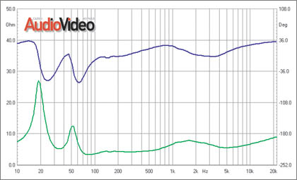

Dependence module Z on the frequency of Jamo S718
System with a fairly steady, but low impedance - the nominal value of 3.2 ohms, it is minimal. It was designed for fans of loud music, and less resistance, the higher the sound pressure at the same output voltage of the amplifier. Noticeable distortion is not expected, since high-frequency output stage will operate in lightweight mode due to higher load resistance. In addition, its reactive component is minimal, that will favorably influence the dynamics.

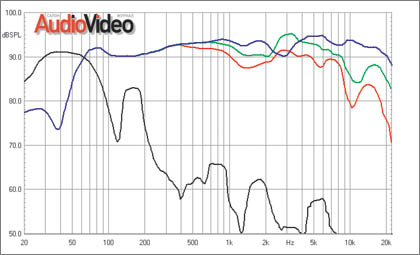

Frequency Response
Jamo S718
Immediately note the high sensitivity acoustic - about 93 dB.
AFC somewhat unusual for Jamo - it is not so linear and has a pronounced rise at high frequencies. However, even with the bass at the S718's all right - LF driver with flared port work up to 30 Hz. Near the frequency section is a failure, which may affect the information content in the upper middle.
Columns better addressed directly to the listener, because the variances bumpers on the case cover the emission tweeter (red and green curves). In general, the pattern is rather broad, so the scene promises to be a clear and stable in space.
