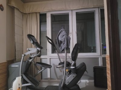

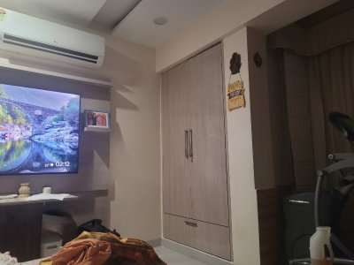

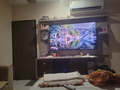

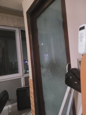

*Can't do much about the room. Have attached pictures of the tv unit. Room is probably 12 x 12 x 11 (height). Balcony wall has been removed and replaced with UPVC and glass. The wall behind my listening position is paneled with teak plywood. It also has a wooden door with a glass panel (bathroom) - can be seen in the picture.20241026_021156.jpg
