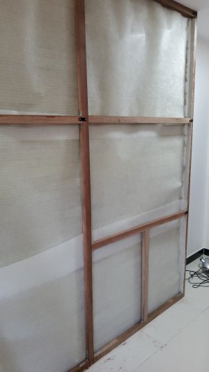

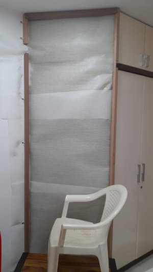

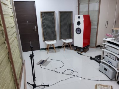

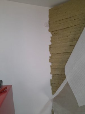

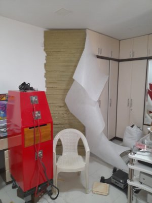

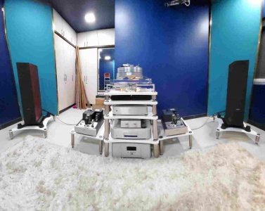

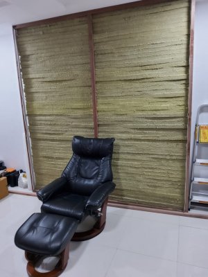

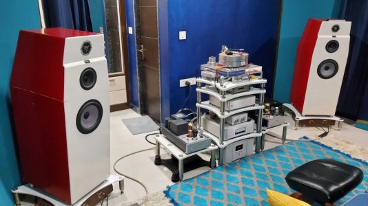

So I started with room treatment,. Everything you see in the pics,  is done by myself. And with absolutely no wood working skills. I bought the tools off amazon and got to work.i spent about 80k in materials, and a month of elbow grease intermittently.  There is about 550 kgs of bass absorption in the room now ( dont ever believe in those 4 inch thick bass panels. They dont have enough mass to really address bass and decay times ). And with just 4 normal absorbers at first reflection points on the side walls. And after all the hard work, when I first switched on my system. I was utterly blown. I would call it a 60% improvement in sound.
I've tried a few bits of kit in my room, speakers, dacs, cables...I think they made a 5% difference in the end sound. But costed a ton lot more. But my room treatment has been an eye opener. My room treatment is not done yet, and I will be at it , for a full year more. So anyone who has a dedicated room  should certainly attempt this cost effective path to nirvana.
