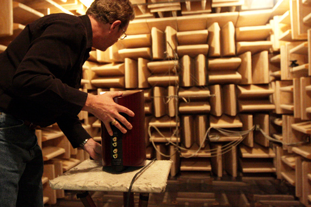

Obviously laws of physics in relation to sound waves will play a role i.e soundstage width is dependent on how wide you place speakers wrt to your listening position. You can't place speakers on a 4 foot wide desk and expect a 12 foot wide stage, nor can you place them 6 inches from the wall behind on a desk and expect any soundstage depth. Also there is the equilateral triangle placement technique etc. but these refer to speaker position wrt to your seat. However with that clear, just because you use steel stands vs some other method of mounting improvement in SQ is highly subjective imo. If heavy steel stands were going to make every book shelf speaker sound great then why wouldn't manufacturers recommend them or sell them with their speakers (some do but majority don't and there is no reference to type of stands in most manuals). And why only heavy metal stands, why not concrete which is heavier and more rigid than steel? Why steel filled with sand or lead pellets? Like I said sonus faber uses wood & marble stand. Also when they test these speakers in anechoic chambers they hardy use rigid steel stands, I have seen everything from flimsy aluminum supports, some jury rigged contraption which can hardly qualify as a stand rather than a support, to hanging speakers from ceiling/wall or simply placing them on the floor in these chambers - please see links and look at the supports they are placing these speakers on/ nor is there any reference to the support. Wouldn't these get the objective measurements wrong? Most important is the location of the speakers from the boundaries of the room, which is going to determine how they sound either in the chamber or in your room. Anyways just my experiences, I have had perhaps 15-20 pairs of bookshelf speakers and perhaps 10 pairs of different type of stands (I have 3 pairs of different types of stands right now). Never found anything concrete to recommend heavy stands vs anything else. Perhaps I am unable or not capable to hear the differences.
http://www.goodsound.com/features/pics/200811_bartonchamber_640w.jpg
http://www.soundstagenetwork.com/measurements/test_loudspeakers.htm
SoundStage! Measurements - How we test loudspeakers...
