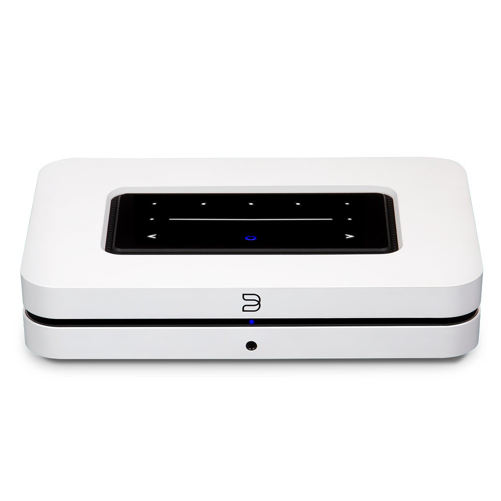

Thanks again @mbhangui - BS node was only removed from the list because of the single SUB out. Yes even we have till now just found the NAD C658. The other Nad products do have dual sub out, however, it doesn't make sense to pay for the amplification :)

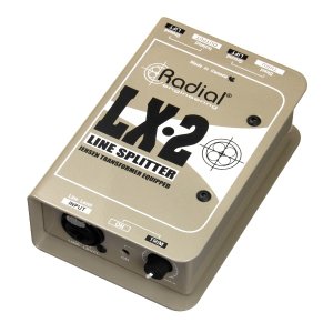

Though somewhat of an expensive solution but just for knowledge share, if you found a product that does not have subwoofer out or just one subwoofer out, this product below can be used.

Also correction - he has 8020C. He has a single TZero Earlier version that he bought from me. It is being used with a BS node 2i currently & he would like to add another T0 MKIII. He is currently using a complicated pro soundcard (Focusrite type of) setup to get Node 2i to output to 8020C as it only has TRX - no RCA. Also he prefers the Sub frequency being managed directly from the streamer for simpler integration, personally I prefer it too. Different strokes for different folks.
