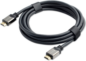

I am looking for a HDMI 2.1 which needs to be at least 10 meters in length. I am redoing my floor and will use this opportunity to lay a HDMI cable from my PC to my receiver/TV. My PC and my setup is located at the opposite ends of my room. Room is 20 feet in length and that is the reason I need a long HDMI which I plan to put under the marbles of the floor. I do not intend to spend a bomb and have shortlisted the following ones.
However, in the description of the Honeywell cable, it's mentioned as HDMI 2.0. Requesting inputs and suggestions. Please suggest if there are alternatives. And suggestions are also welcome on my plan to use such a long HDMI cable - should I worry about anything?

Bluerigger Limited-time deal: BlueRigger Ultra Series 8K HDMI to HDMI Cable with 48Gbps Speed, (20 Feet / 6 Meter) Supports 8K@60HZ, 4K@120HZ, 1080p FullHD, UHD/Ultra HD, 3D, High Speed with Ethernet, ARC, PS4, Xbox, HDTV https://amzn.eu/d/0hOIr1y
Bluerigger is v good .I'm using it.
Thanks Girish.
I am thinking of the following option from Bluerigger.
I'm using bluerigger 25ft for about 2 years without any issues. Many of my cables are from the same brand and I can confidently say good quality brand.
I was actually going to suggest Bluerigger as well. I have a few of bluerigger cables and they are very well built and the quality shows. For about 4500, it's a decent deal for 10 meters.
Regarding putting the cable below marble or in wall, make sure you use a good quality conduit pipe, wide enough for the heads of the HDMI cable to pass through. It shouldn't be an issue that way as electricians can pull wires/cables through long conduits without trouble.

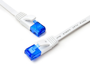

Also, just a random suggestion, if you don't have LAN near your setup, you can think about adding that too along with this, may come in handy in future.
+1
That way, no need to run a HDMI cable to your TV. A good CAT6 would suffice.

I have ordered the following two cables together and will put both the cables together through a 3/4 inch conduit pipe. Will need a pair of HDMI extender for the Cat 6 cable once the room is done. This pipe will go under the floor marbles. I have decided to have both Cat6 and HDMI them so that in case one gives me pain, the other can do the job till the pain is fixed!
