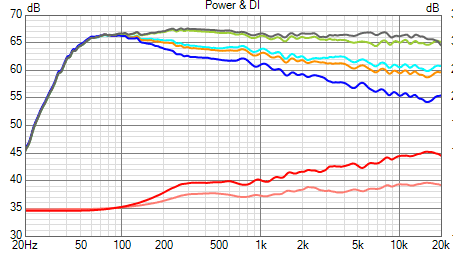

This is one of my speaker configuration's responses with the above kind of tuning (anechoic). I find the sound anything but 'flat' even on music streamed from youtube
wavecor_mid_3way_linear_phase_spl-jpg.1118467

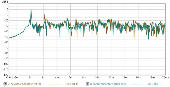

Here are ETC measurements that show up at the listening position with and without a carpet on the floor.
The above measurement shows that the carpet on the floor has significantly impacted the first reflections for the better, and that translates to a significant perceivable effect in sound in the room, like much cleaner imaging with a stereo pair of the speakers mentioned above
