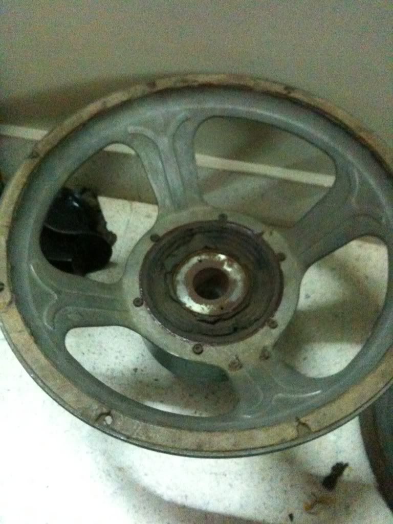

After a long while I have finally opened the Altec 605Bs up and will have to start by doing some cleaning. Rust on the HF plate and rust in one of the HF throats. Did some reading up suggestions on the net were vinegar or baking soda mixed with water to form a paste. One question I have is whether I can just pour water down the horn throat and in the HF voicecoil gap? There does not seem to be anything that can get damaged and it might flush the removed rust out afterwards... Thoughts? Pics to come.

http://i1122.photobucket.com/albums...4-BEA8-428A0280174C-2163-0000035E97C9ADA6.jpg

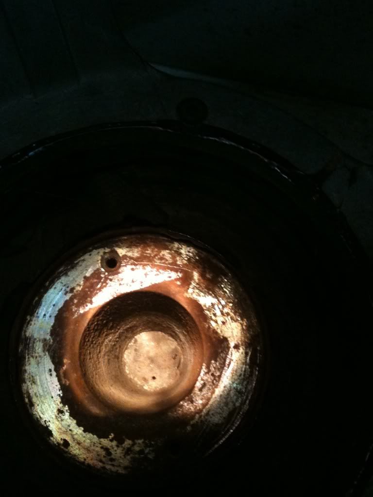

The inside of the HF throat. Cleaning this will take some careful doing. Amy tips on the best way to do it? So far thinking of carefully soaking sections with vinegar using earbuds and wiping carefully every ten mins or so. Keeping the basket sideways so it does not drip down.

Rajiv I'm not sure that there is rust in the voice coil gap. Can't see inside. What do I do? Any way to find out? The current voice coil is extremely scratchy going in and out so lots of debris for sure. The rusty driver guy on hostboard used fine emery paper to do the voice coil gap and then that sticky tape to clean up.
OMG, you want to use vinegar which is acidic in nature and would promote further oxidation!!
You must use a reducing agent to reverse the effects of oxygen on the Iron material which has resulted in formation of ferrous oxide (rust) in the first place. If I were you, I would be soaking the whole thing in commercially available rust removers and brushing and washing off the muck.

Steven rust anywhere is bad news. :sad:In your case the rust seems to be in the throat area,and can be got rid of without any major disassembly of the driver.
First is to check if there is no rust debris in the voice coil gaps of the woofer and tweeter.Use a 1/4? piece of shim or thin card stock. Fold a piece of masking tape over it- sticky side out. Pull tight. Insert into gap and move until you have worked around the entire circle. Repeat until the tape remains clean several times.
If there is rust it will be seen on the tape,then you might have to use a fine emery to clean the rust out and then repeat the masking tape process.
After cleaning the gaps cover them with masking tape so that further dust,rust from cleaning the HF throat does not get in. You may get rust into the HF voice coil gap from the phase plug area when cleaning the throats of the HF drivers. So cleaning the throats with the drivers facing down is a good idea. After cleaning you can blow out any dust/debris with a blower.
The "paper diaphgram" you refer to is a bug screen that is there in many compression driver to prevent dust,etc from getting into the phase plug .In the picture you have attached the rust/dust has blocked the screen compleatly.It has to be removed.No need to replace.
You have to be careful to ensure that the rust/dust does not get into the phase plug and voice coil while removing/cleaning the throat.

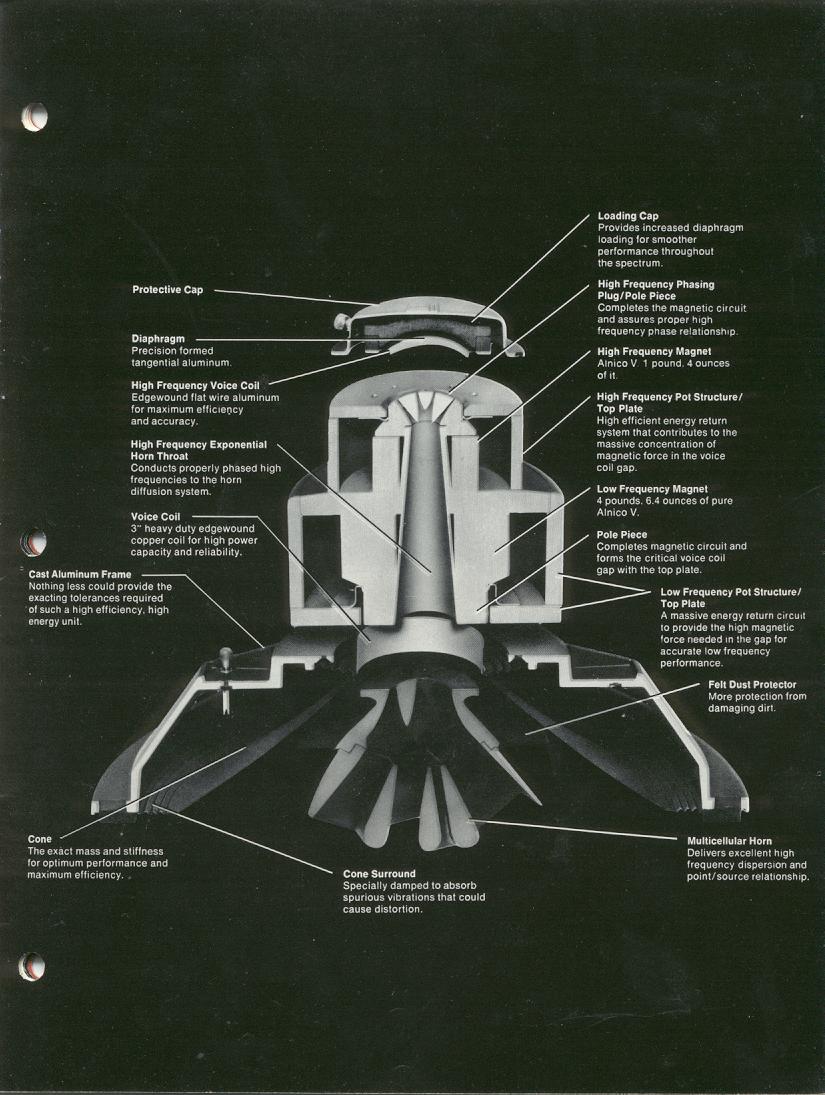

Also from the crosssection pic. of altec 604 it looks like there ought to be a coil below the small cone on which bigger cone is attached. 5th item on left. Not sure though.
