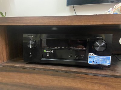

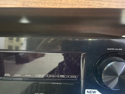

I wasn't feeling well, so I couldn't respond. I went to a technician referred by a forum member. We conducted analyses with all speakers, one speaker, and various speakers. It's not overheating; he stated there appear to be no issues with the power board; the problem may be ventilation. It runs perfectly when kept with open ventilation, but when we place any object above it, it goes into standby mode. * The technician is still watching to see if there is another cause.

Ventilation. Key Word. Receivers need plenty of ventilation around them. Do Not keep them inside cabinets, covered shelves or place things over them. You'll find this mentioned in its manual too.

The spacing seems fine
I have been using my Onkyo AVR in even tighter space for years and there is no problem at all. I have used multiple Onkyo AVRs there and all worked fine.
And yes do not keep anything on the AVR as heat gets out mostly from the top. These AVRs do not have fans so need some space above for the warm air to pass through the top.
