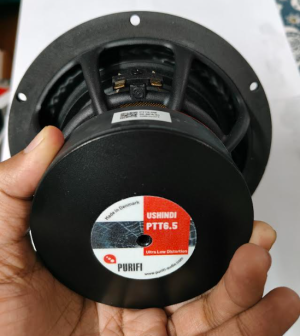

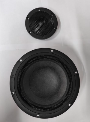

For the mids, I chose the following driver: https://ptt.purifi-audio.com/shop/p...,4120,4121,4122,4123,4124,4125,4126,4127,4128
I think I need not speak more about this driver. But for the sake of completeness, it is an ultra-low distortion, relatively high sensitivity midrange driver :)

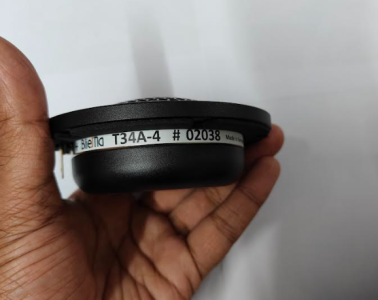

For the highs, I chose the following driver: https://hificompass.com/en/reviews/bliesma-t34a-4-34mm-alumag-dome-tweeter
It is the reigning king in large dome tweeters with a wide radiation pattern and very high breakup for a non-beryllium diaphragm.. :)
I could have gone for a beryllium tweeter from Bliesma but I chose this one because it has some very special properties. The most important is that it can be put in a very shallow waveguide with an ultra-wide, controlled directivity configuration. ;)

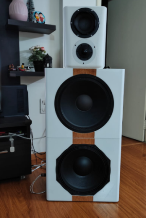

Here are some pics:
The cabinet design (size/shape) is being studied for the best performance with these driver choices so it is not yet finalized.
But this 2-way system will be crossed over below 200Hz, most probably to the 4 x 15inch woofer system radiating in cardioid mode..
The 2way top module will most probably have a passive crossover and will be powered by (most probably) a Purifi Eigentakt amplifier..
The crossover between the top module and the 15inch woofers below will be active..
However, all these details are evolving at the moment so I will update this thread as and when the system design reaches significant milestones.
Those interested, watch this space.. :)

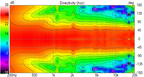

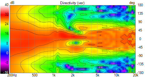

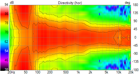

@Yelamanchili manohar : The goal/theme with this system is wide controlled directivity with ultra low distortion and high dynamics capability.
The advantage of my dual 15inch woofer module is that it gives cardioidish directivity all the way down to 100Hz.. Unless I build a brand new concept and bass module using WO24Ps, I wont be able to get that level of directivity control with this system..
Dont believe me? ;)

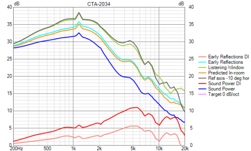

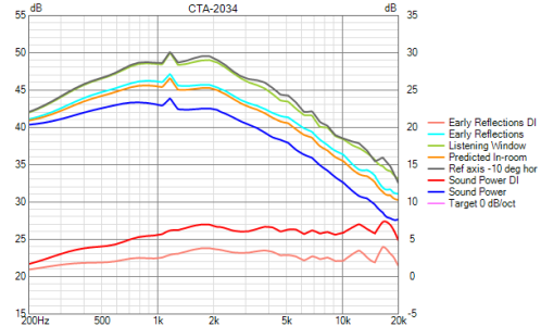

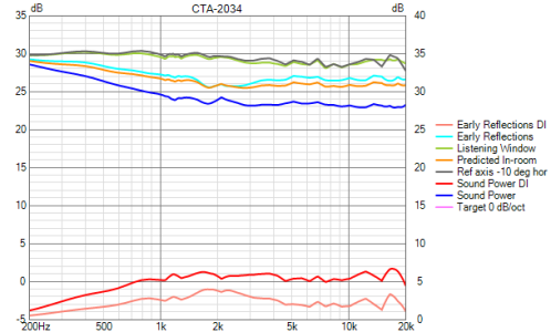

Here is the concept overall 4 way system using real polar measurements of my dual 15inch system (15PR400 & NERO SW800) + simulated polars for the waveguided tweeter and purifi mid all stitched together with a prototype crossover.
It is all about balancing energy radiated into space, if we allow for abrupt changes in directivity over a short range of frequencies especially above 400Hz, it will make itself known/present allowing one to not focus on other parts of the spectrum while playing music.
This has been my experience with high directivity horns partnered with direct radiating dual Satori woofers. There was a 5ish dB change in directivity over and range of about 400Hz to 2 kHz in that system... The result was extra detailed vocals but not allowing one to focus on the fine details in upper treble during music playback.. It will all be there in the music, but it is hard to notice/hear it because the brain gets locked on/focusses to the more energy sprayed out in the other range of frequencies. Or at least this is my hypothesis.

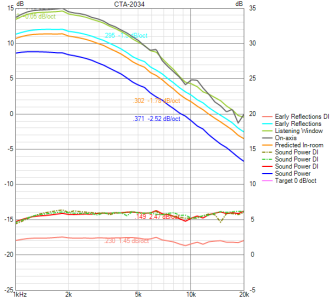

This is the reason why I am trying to make the Sound Power DI in above CTA 2034 curve as smooth and as much "jump" less as possible/slowly climb up (the inevitable DI climb up with these kind of drivers).. :) If you check above plot, it is hardly a 2dB change from 150Hz to 20 kHz.

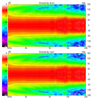

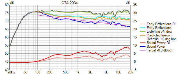

Now compare that with the sound power DI in the below system (Dual Satori WO24P + EXAR 400 horn)
But all that said this system design is not yet frozen so changes may come w.r.t overall configurations.. :)

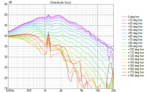

That is awesome directivity control from 100 hz onwards. I did read in your previous build about the cardoid bass directivity. Very impressive indeed. Now I will just sit in the audience and watch the build, without further interruptions 🤣

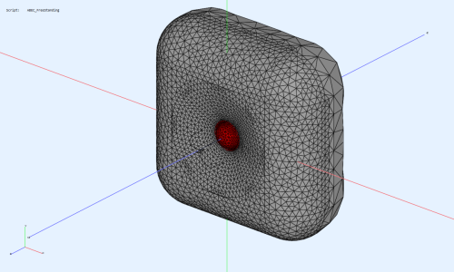

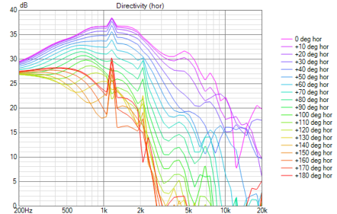

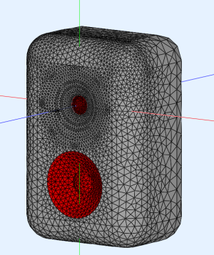

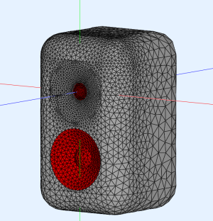

So this is what is possible with both the Purifi 6.5inch and the Bliesma T34 in a shallow waveguide (150mm diameter, 16mm deep).
Cabinet dimensions: Width x Depth x height = 270mm x 200mm x 394mm
The height dimension can be reduced to 344mm by reducing the rounding at top and bottom to 30mm each instead of 50mm in the current pic. It will definitely have a minor impact on the vertical directivity.
At least the width dimension & 50mm rounding are needed for proper edge termination of the waveguide & avoiding midrange narrowing with the waveguide.

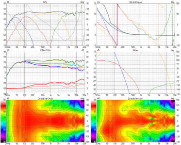

Tweeter in waveguide raw response curves (ignore the peaks around 1164Hz. It would be a simulation issue):
Woofer in waveguide raw response curves (ignore the peaks around 1164Hz. It would be a simulation issue):

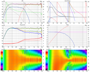

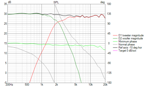

The full speaker response with a prototype crossover
What is missing in the modeling is the purifi driver mid break up region and the EQ required to tame it..
But it very manageable with this driver

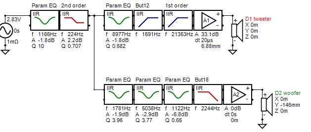

I did try out creating a mono speaker out of this system for listening impressions and study the performance both objectively and subjectively. I am yet to get the waveguide printed so the Bliesma tweeter is currently used in direct radiating configuration in a shaped cabinet.
Here are some pics and latest crossover configuration details:

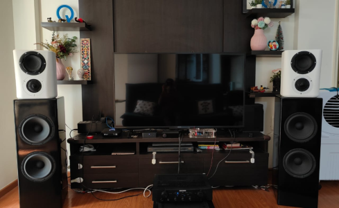

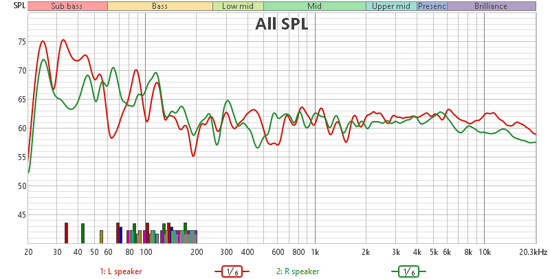

This is the final speaker configuration with the Purebliss system. The two way Purebliss tops (3D printed enclosures, for now) along the the dual Satori woofers making a 3way system
My current favourite crossover dialed in using the minidsp flex-8

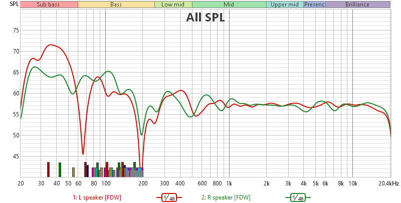

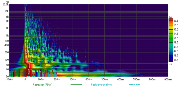

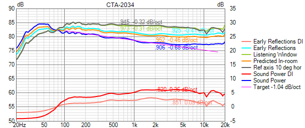

Measurements of both speakers from MLP
The above frequency-dependent windowing applied shows the effects of the early reflections.
Floor + ceiling (some amount of left side wall) majorly contributes to the nulls around 200Hz, 500Hz & 900 Hz.
That 65Hz null may be a room mode or a reflection I guess..
Subjective impressions of stereo Purifi+T34A+Satori WO24P system
1) There is an ease/effortlessness/balance in the sound through the whole spectrum of sounds I care about that I haven't found in any of the speakers I have tried so far.
2) That slight rib cage massaging bass is back with this woofer system, and I am happy again.
3) The imaging is ever so slightly hazy/not as well defined as the horn system, which is probably to be expected. But I don't miss the etched-out sort of imaging. But this system is much more balanced. I can hear a lot of things in music which I have "never heard" before (all those little nuances are so enjoyable to hear and I wonder how I missed all of those earlier).
4) As I have remarked in the previous post, the spatial presentation is completely different to any other speaker I have ever heard. The depth and width of the soundstage have increased significantly. Also, the soundstage is now occupied by all of those little nuances in treble and mids.
The more I have been listening to this Purebliss speaker system, the more I like them..
I can confidently say that this is the overall best speaker I have listened to in the last 4 years of my speaker-making journey in terms of balanced sound.

Not only in terms of measured technical performance, but also in terms of perceived sound in room. :)
I haven't heard anything like them in my audio journey. I have been through low-cost drivers (tweeters + mids), mid-priced ones, compression drivers and few horns, etc. But this driver combination is the best I have heard in my listening space.
They really can make an end game system. Period.
