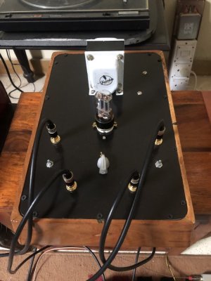

Latest creation: 6SN7 Tube preamp. An eye opener for me. Probably simplest tube preamp with maximal tube sonics and wide frequency response. Excellent mate to both SS or Tube amps..
