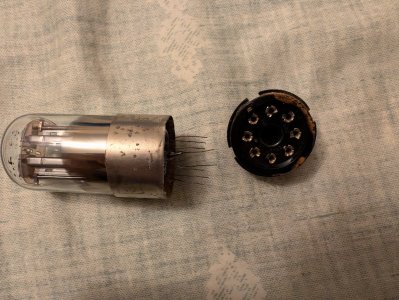

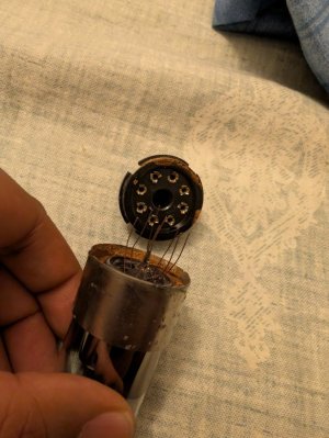

I have a pair of well testing Melz that met with an accident. See pics. I'm told it just needs the pins connected back and soldered. But I have no experience in soldering or to test if it's working ok..
Can anyone share any leads for someone who can fix this.. preferably in Delhi ncr?

For soldering, any audio video shop. If there's an internal issue, then a word of caution, as you will be handling high DC voltages.

Ship them to me. If it's doable, will do it and ship back.
Can you post closeup pictures of the pin side of the socket ?
I figured out how to solder them. But I wonder how all of them came apart.
Using SMD soldering paste and heat gun?
Nope. Will use soldering iron only. This will demand a lot of patience.

It's a soldering job that's what the seller told me. The glass tube is intact, just that the base came off due to drying glue.
Damn crazy experience of my life in the tube world ! I sat down to repair the tube and realized I have no inkling on the tube wire identification. Still went ahead. At first seemed to be an impossible task but still trusted my hunch and experience so far.
Tested the heaters. Bingo !
Mustered enough courage to play in my amplifier. Bingo !!!
