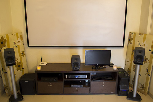

I have a similar setup now, two 2x4 ft panels of 2 inch glasswool. It did not help much in the lower bass range but ofcourse, it is too less coverage of corners. Now will work on 4 inch panels as tall as possible on all 4 corners.
My setup has changed much since this photo was taken, but it shows how the said panels are placed and the problem of insufficient space on the sides.
Yup, those panels are already at the right location. Just replace them and add the same to the back corners.
