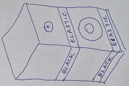

I had an issue with the grill of the Wharfedale 9.0. The 4 attachment lugs had broken off. So I bought some 1 inch wide black elastic roll from Amazon, cut off the appropriate length, clipped the two ends of the elastic together with staples and wrapped it around the speaker. It holds the grill in place and looks nice too.
Since the 9.0s are quite small, I needed only one elastic band per speaker. Bigger speakers will require 2 elastic bands of course .....

I have the same problem. Lugs broken for both speakers. Can you please post picture of this arrangement.
Unfortunately, I'm on an assignment to a different city and I've temporarily relocated without my HT gear. So I can't show you any pics. I'll do the next best thing by attaching a hand drawing of what I had done.1000145887.jpg
You may need to use 2 or 3 strips positioned between the drivers, so that sound output is not affected.
You can easily buy these strips on Amazon. They are mostly used for stitching clothes.

You have to make sure that these strips fall between the individual drivers. See my attached pic.
Once you do that, I think the differences, it at all, would be negligible.
I had used this technique on small bookshelves less than 12 inches in height, which were being used as surrounds. The Wharfedale 9.0s have only 2 drivers, so just one strip placed between the tweeter and the tiny woofer was enough to hold the grill in place.
